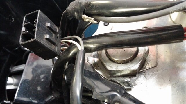

I didn't know that. The locking tab HD part # 45794-94A
I attached a pic of what it looks like. I just replaced the fork oil on my trike yesterday and checked to make sure the stem was still tight and adjusted correctly, so I snapped a pic of the tab. Locking tab.jpg
I attached a pic of what it looks like. I just replaced the fork oil on my trike yesterday and checked to make sure the stem was still tight and adjusted correctly, so I snapped a pic of the tab. View attachment 18661
What's keeping that locking tab in place?
Butch
Butch
There is a roll pin that holds it in place. If you go to Ronnies parts finder and look up 2008 FLTR Roadglide, subsection "Suspension Steering Stem w/Bracket you will see the parts picture break down
