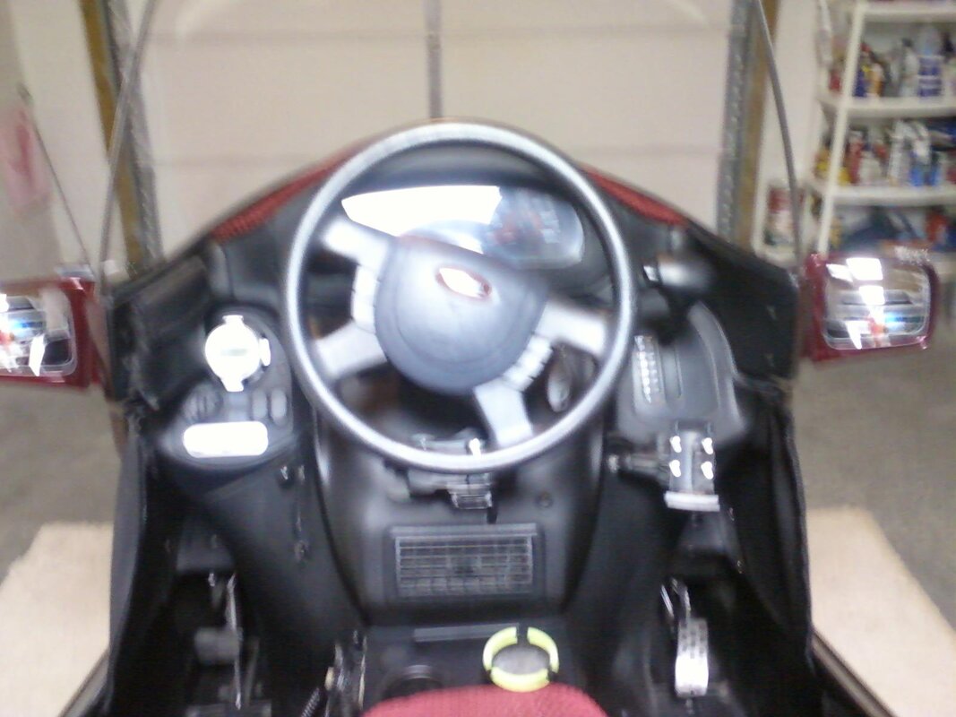

Hello; StallionTech, I need some help please; I have ask this on the fourm several times but, I guess no-one has ever had to do it yet. I need to know how to remove my steering-wheel and replace it because; when driving straight my wheel is tilted badly to the Right and should be straight across and it makes it hard to go around curves, any help would be greatly appreciated. You can email or pm me

Thanks for the help guys, question am I suppost to see the wheel move when I turn the adjustment screw. Little confused here, When I have the gear shift in drive the steerwheel cross peice is pointing directly to the shifter thats to the right, thats how far its out of adjustment can all that be pulled in and make the wheel straight again its really hard to take curves this away especially making any speed.

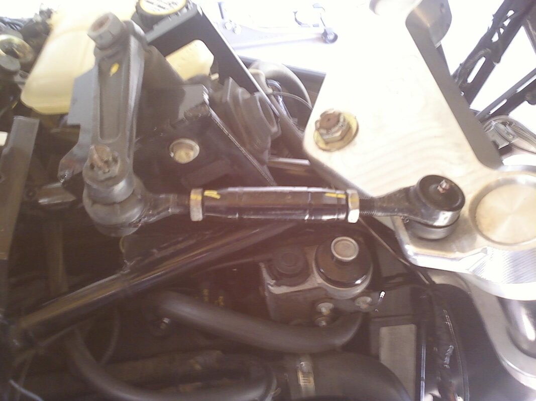

I am confused :xzqxz: what linage is everyone talking about on the stallion, is it the large rod type thing on top that has 2 nuts on both sides and a large piece in the middle of the nuts, do I loosen the nuts and turn the large center piece to adjust the steeringwheel or what? Trying to do it today so I can take advantage of the warm weather :) any help or maybe a picture would be greatly appreciated. Is this the adjustment rod in the picture, if so I loosen the 2 nuts and the center part wouldn't turn at all please help.

Ted, I don't know why it is out so far I bought the trike from Blackburn's Trikes in Ohio and it was like that when they bought it to me, I also had to put a cruise control unit on it.

You make the adjustment on that large rod with the nuts. One turn on that rod should be enough to correct yours. Mine was out that much originally. Now, I can't tell you which way to turn it. You will have to do trial & error. A small amount of adjustment will be very noticeable. Good Luck!!!

Sorry for the delay, I didn't fire up my PC yesterday. I didn't have any difficulty in turning the barrel of the rod once I loosened the two jamnuts. You might call Richard at TBMS and see if he

Sorry! for the late reply Gorilla, I did everything that was told to me on this fourm. I first had to spray the rod in the picture with wd-40 and let it set overnight, then the next morning I loosened the 2 nuts in the picture, and made sure the ignition was on and the front wheel was on the ground and as straight as I could get it then took I believe it was a 7/8" open-end wrench and turned the large rod counter-clockwise just a small portioon at a time you could see the steeringwheel straightening up. Then tighten the 2 nuts back down and test drove several times making morre adjustments the same way and finally got it straight. Hope this helps!!! :) NOTE: make sure to hold the wrench on the rod and keep it from turning when retightening the 2 nuts.
