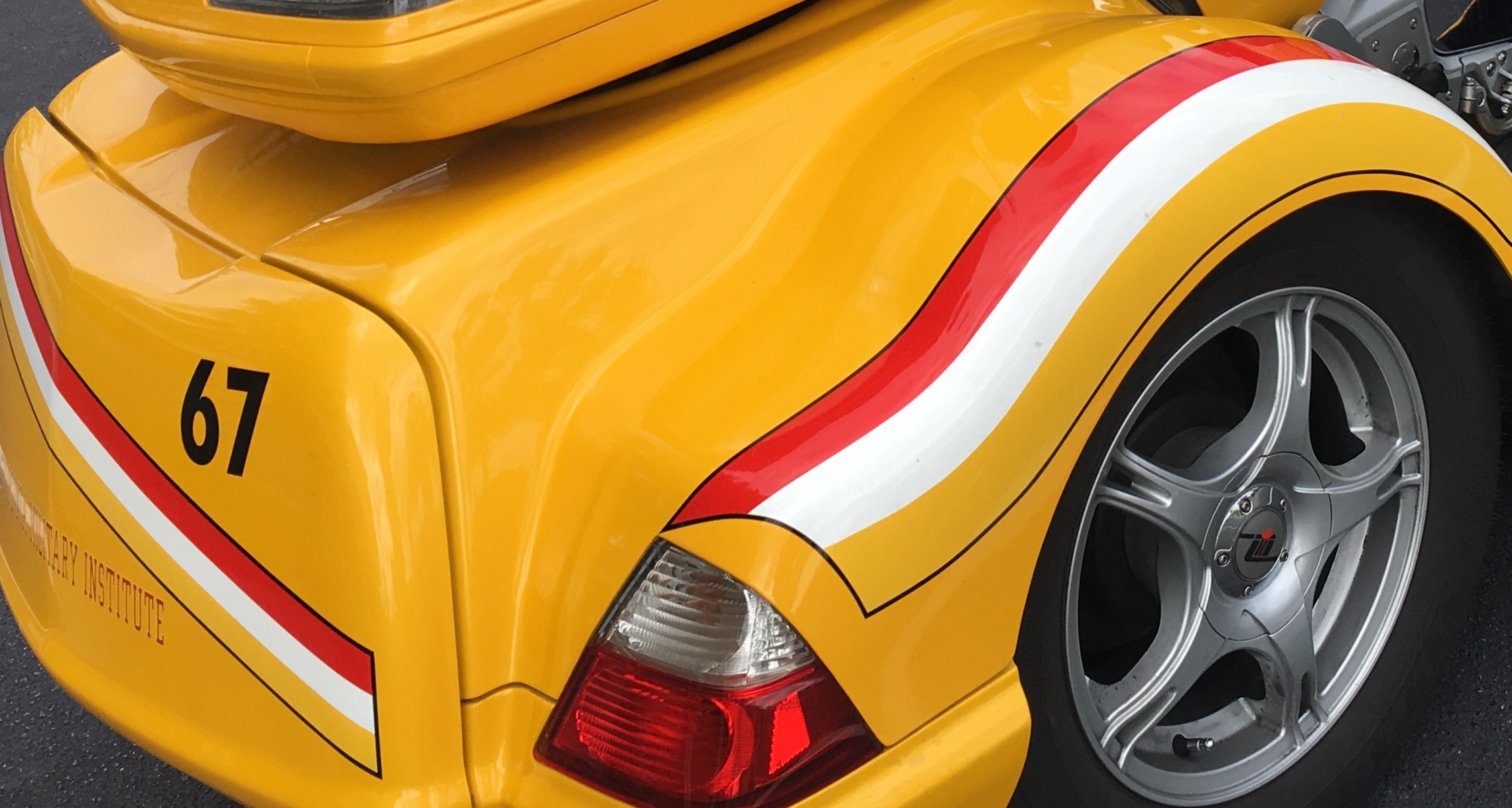

photo of painted stripes
IMG_4373.JPGThere are stripes over each fender and one diagonal one on the trunk cover
If they are decals they probably were clear coated over them. Then you are right back to if they were paint. You can get the decal off but the clear coat will have an edge at the decal. Plus the decal is hard to remove but can be done.
If he did that with a rattle can he is good. If you still have contact with him maybe he can tell you what brand he used. Then you can contact them and ask them what they say.

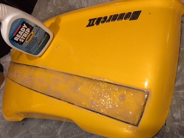

Update.....
D0076F4E-7640-4D67-B829-5B2F48DDD0C9.jpegHi folks,
Sorry I’ve been quiet for a while. Did quite a bit of googling and away (at the F1 GP in Austin, TX 🙂).
So I found a product, Ready Strip Marine, that supposedly takes layers of anti-fouling paint off boat hulls. No volatiles and it won’t affect gel cotes. I ran a small sample - directions say between 30 minutes and 4 hours soaking. I got distracted and left it for almost 5 hours, with a layer it cling wrap over it to keep it moist.
I got a fairly decent result, so I removed my truck lid today and decided to do the blue, white and yellow stripes, as well as the black pinstripes. I thought they may be “decal-type” stripes and peel off, but they are the toughest part to remove. I left the Ready strip on on for 6 hours, and the paint bubbled and was easy to white off. From the picture you can see I’ve reapplied the stuff and hoping that everything will be removed now.
I’ll update as I progress.
