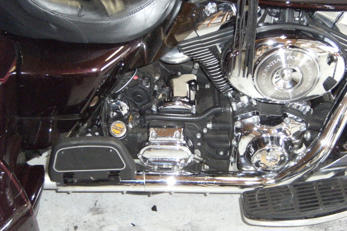

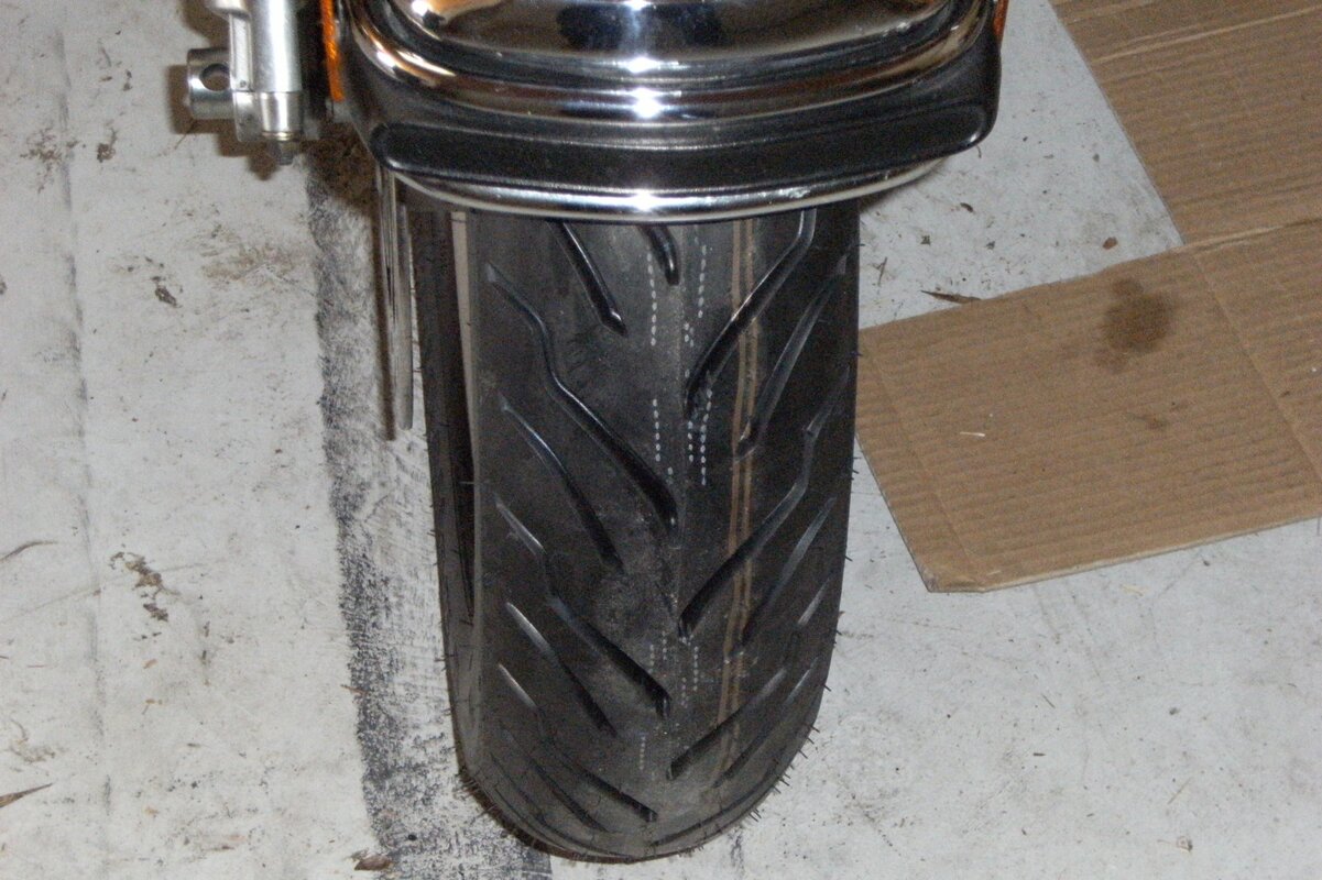

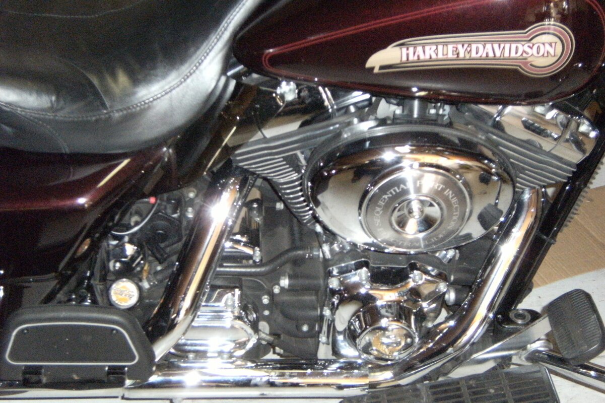

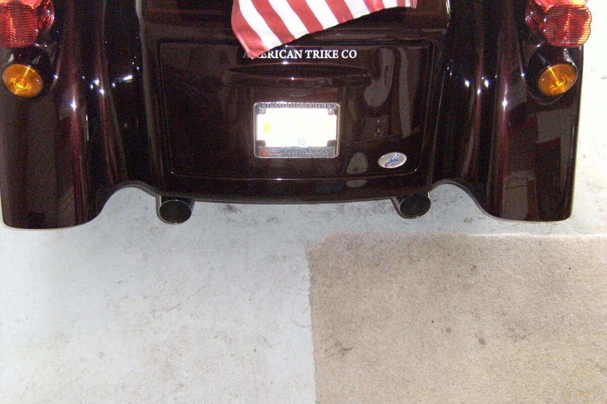

Fullsac true dual conversion kit ... had to make a few adjustments to fit my Champion conversion but not to bad to install. Did it my self taking my time over two days in about 8 hours. Reinstalling the mufflers was time consuming. Sound is fantastic what it should be, in my opinion. New rear Dunlop Elite 2 on front as well. Ready to roll!

I installed CFR (knock-offs) 4" Megaphones on my Freewheeler, very nice deep rumble. I've tried to record the mufflers, but the sound you get from my cell phone really sucks, probably would scare people away from these pipes. Only had to change the mufflers, and they cost $175 for the pair. They are the same mufflers I put on wife's '14 Tri-Glide. They are 2" longer than the stock muffler, but fit well. MAJOR pain in the ass to install. If I had to do it again I'd remove the lower valence and bumper. Would be much easier to tighten the rear hanger bolt.
All I was looking for was NOISE, performance is fine with me so saving a grand made sense to me.

I was looking for a better Harley rumble ... got it ! PS the sound recording on my camera was good ...
