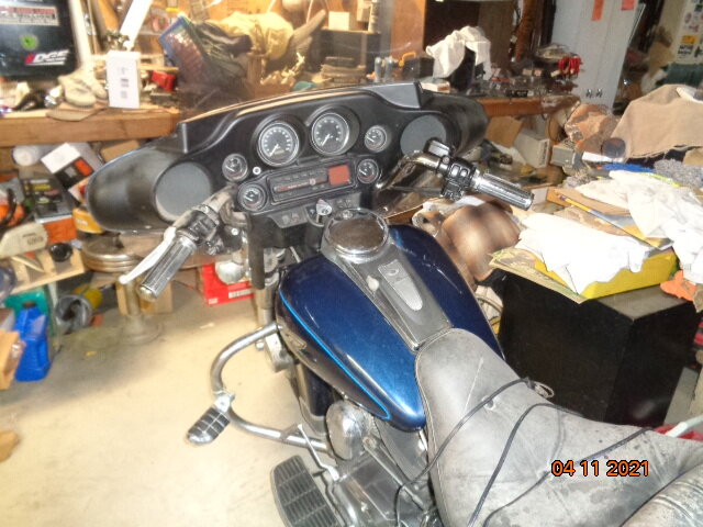

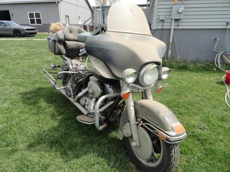

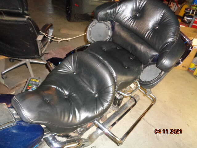

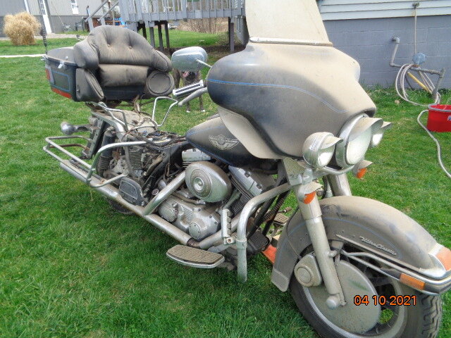

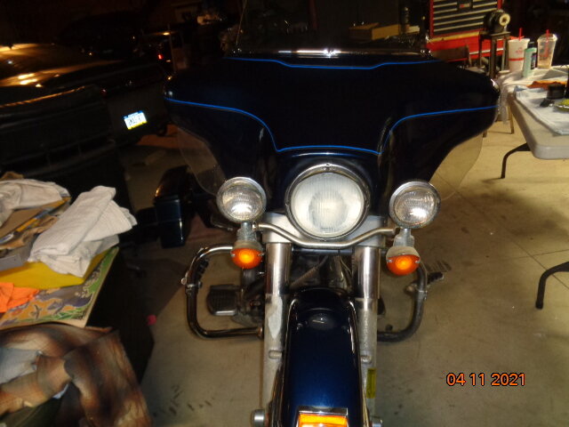

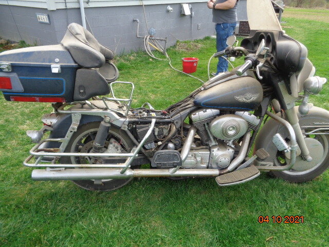

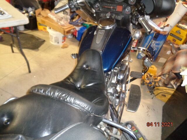

Many months ago my son and a friend showed up with an 03' ultra Classic View attachment 98055View attachment 98056So It sat in the garage all winter long filthy beside old shiney.
Then the spring warm up
time for a bath
Wow, quite the transformation Fred.

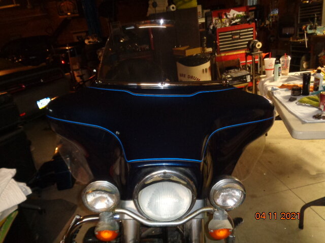

This was Jon's father's Ultra he hasn't ridden it since his father passed away close to 10 years ago (a little emotional about it.) . It sat on a porch that was partially enclosed. We pumped up the rotten tires and put in a new battery. A little fresh gas and it started up a little rough but it started. A pile of elbow grease is still needed and I gave him a newer windscreen he like the recurve 10" way to tall for me. New fork legs from Ohio and shop manuals as well, AKA (PosseRider) also donated a sensor thanks again for helping this young man get this old Ultra back on the road when it's completed I'll post more. Ride safe Fred
It cleaned up pretty darn good, I wasn't sure what color it was, but surprise it is a nice blue
Good job Fred
No I didn't do it I supervised this is something Jon had to do for himself. Advice cleaning supplies etc. And a lot of listening while Jon talked about his father. Really nice to be a part of the resurrection of the old Harley. Travel safe Fred

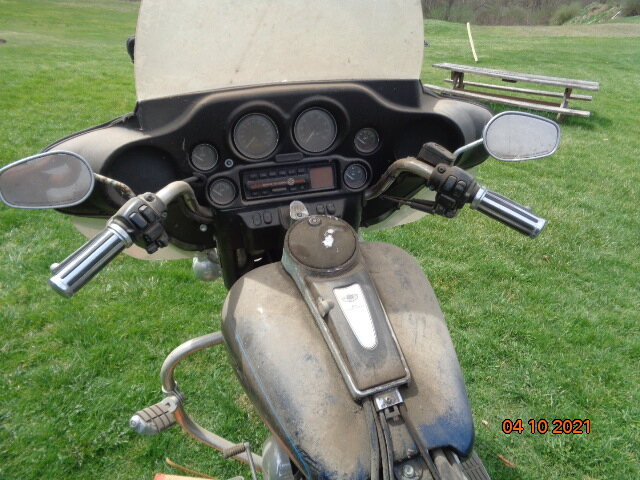

Mirrors are really bad shape
Would anyone have OEM take off mirrors Jon's mirrors a rusted and pealing off really ugly let me know how what you want for them. Fred
If you can't find them......Just sand the rust off of them then rattle can them the same color as the faring...Then rattle can over them with clear coat....
Thank you arrived today's mail. I really appreciate the kindness ride safe Fred
You are welcome , let me no about the saddlebag guards I have a lot of late model , I will check for older one's to see if I have a good set ?

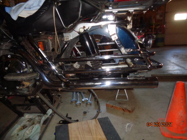

The corrosion on the bars is bad front support on left side. And right-side is not any better. Again thank you Jon works everyday but really is on a tight budget, and he like you is a good person. Ride safe Fred 🙏

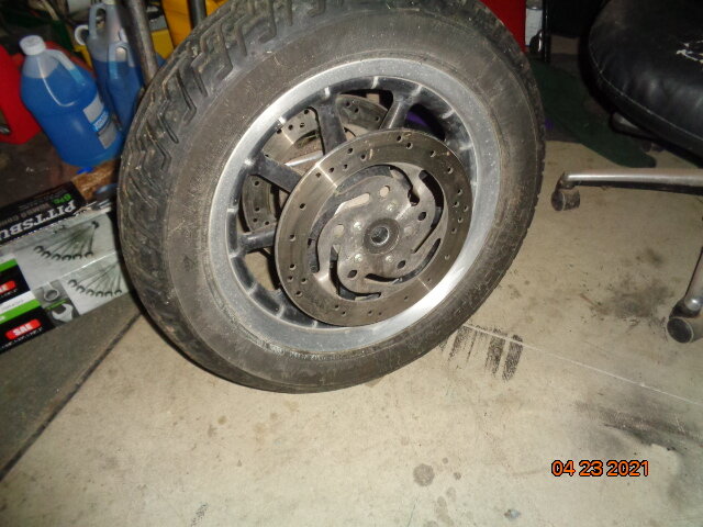

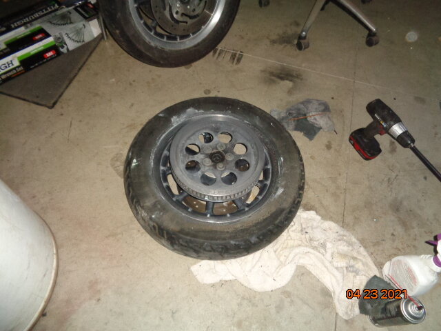

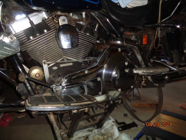

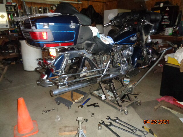

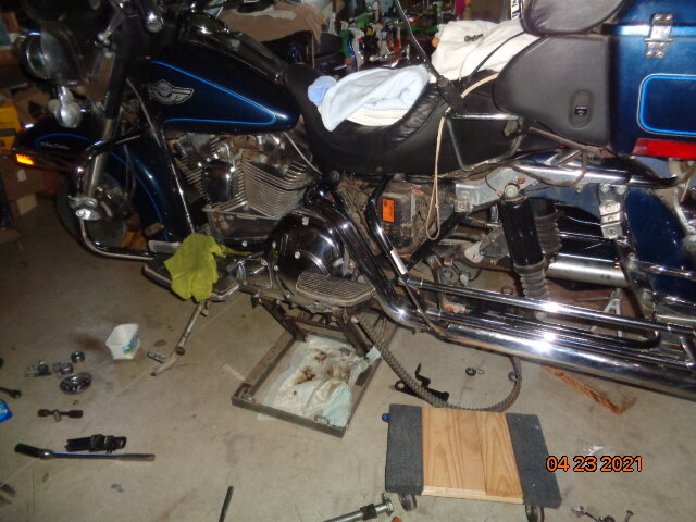

Well Jon is at it still New Tires and elbow grease lots of elbow grease. The wheels areanightmareDSC01976.JPGDSC01977.JPGDSC01978.JPGDSC01979.JPGDSC01980.JPGDSC01981.JPGDSC01982.JPG He is considering upgrading the cam chest to gear drive cams not trusting the the old spring cam chain tensioners

Thank you let me know Jon is finding out about cleaning behind rotors waht an education that is LOL... We are possibly going to do the cam chest I'm sure it still has the spring tensioners in there not good for a young man and old Harley. Not sure which way to go any Ideas would be welcomed. Fred
Fred, first thing to do is crank run out. This will tell you if an update to the hydraulic tensioners is for you, don't forget the inner cam bearing upgrade
Check the oil filter for shiny brass pieces also
