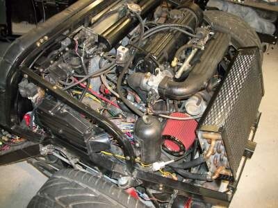

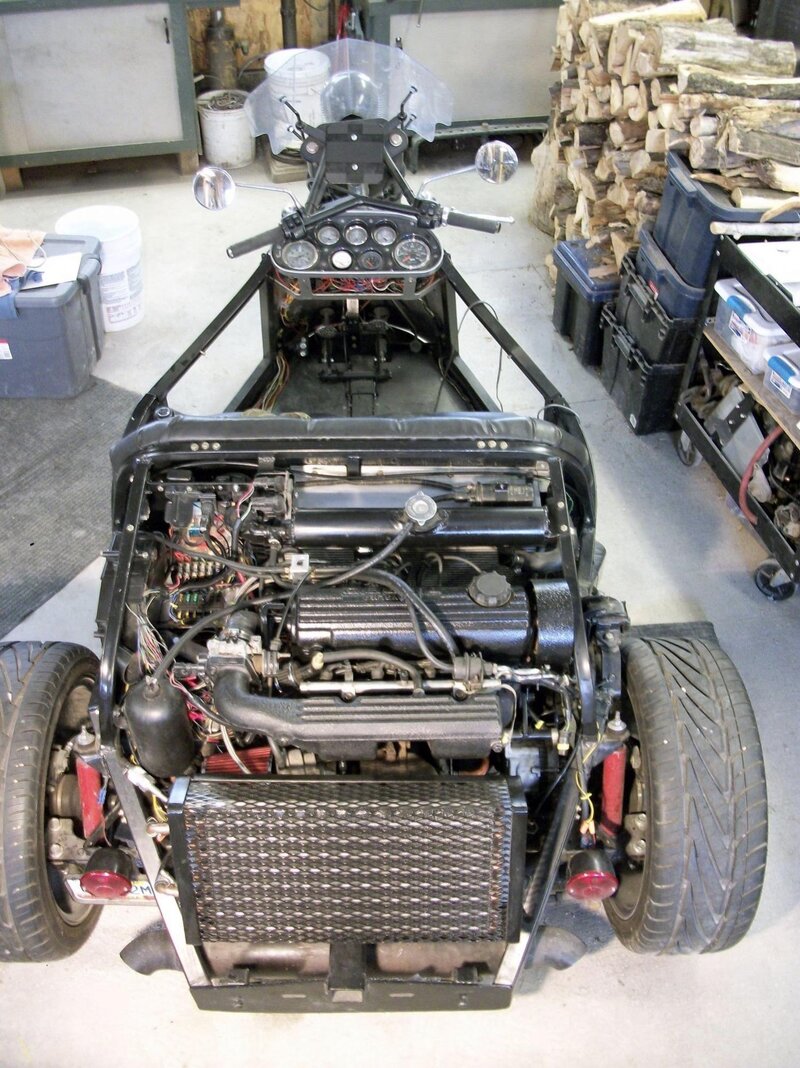

Another view....having trouble with resized pics.
Its a 1985 chrysler 2.2 t1 short block. The head/intake/turbo is a 1992 782 swirl head....a modernized version of the original. The main difference would be that the throttle was a draw thru....now it is a blow thru, which was a change needed when chrysler started using an intercooler.
My setup is called the t1 which doesn,t have the intercooler, in other words, boost must be limited to levels below the t2 setup. Also 1992 t1 used mitsubishi turbos instead of garretts. So powerwise will make about 150hp. T2 setups with calibrations and big boost can make 350 @ the wheels on these older 8 valve engines. I am more interested in reliability than hp at this point.

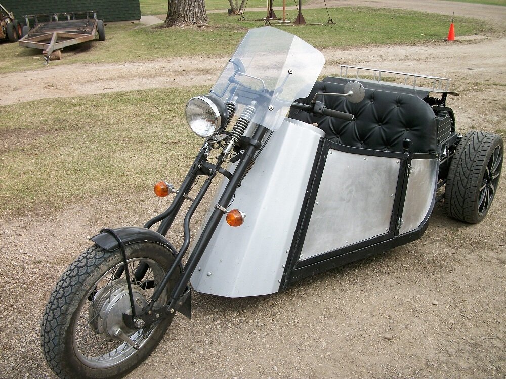

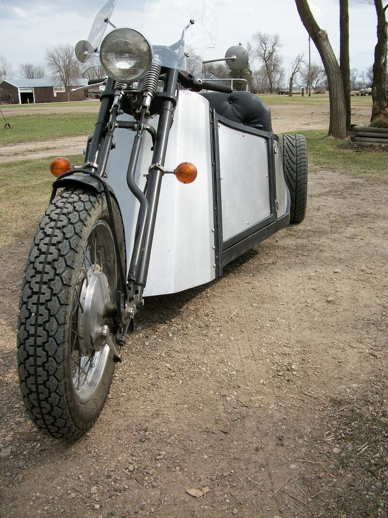

When and if engine issues are resolved, next job will be to sheet in the front doors and quarter panel access doors.
I have 1/8 aluminum sheet that will be pop riveted to tabs that will be welded to the door frames. The original idea was for a chariot style, 3 season trike, in fact, it still is, just to get it done!
