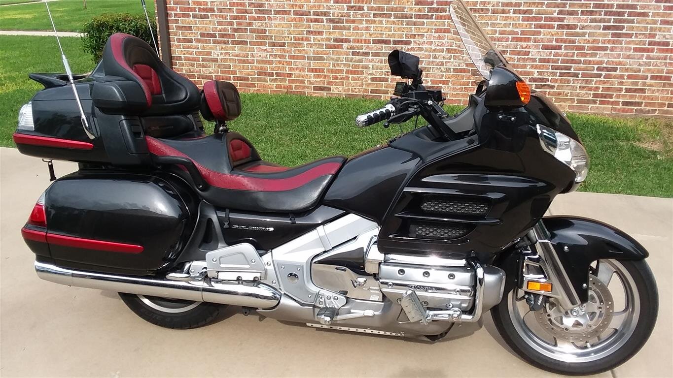

I've never seen a "solo" seat offered for a Goldwing. The closest thing I could suggest is a Ultimate King-Rider. Ultimate offers a Mid-Rider that is close to stock seating position. Their King-Rider gives the driver a little more room. They say it is for riders that are 6' 3" tall and over 260lbs. I'm not near that big of a guy, but I love my King-Rider. Check out all of the options at Ultimate Seats.
https://ultimateseats.ca/honda-motorcycle-accessories/gl1800-goldwing-seats
My King-Rider on my GL1800
My knees were also almost touching the dash buttons and my one knee was bothering me after a couple of hours riding from being bent so far back to reach the stock pegs.
I just got my seat back from Tom Simmons who customized it and did a wonderful job. He moved my position back 1.5 inches as well as moving the back rider back that as well. That ended up putting less strain on my knees as well.
Tom’s website is http://tscustomseats.com/ and he’s on Facebook as well.
