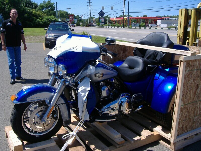

The first year of manufacture for the Tri-Glide saw the "front" built by HD, shipped to Lehman, where the "trike" portion was added.
The Tri-Glide then went "in-house" to HD.
Champion purchased Lehman after that.

Lehman helped Harley with the engineering of the Triglide, they also assembled the 2009 - 2010 back half at their factory. Starting with the 2011 MY Harley moved the total build to the York Pa plant.

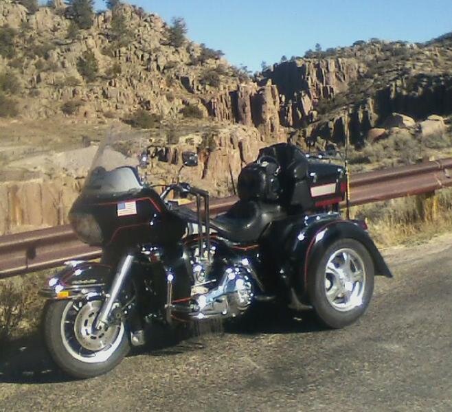

I have an 80" evo on my old tour glide with an e-27 cam (just a might hotter than stock) and suits me fine with a top end a little over 90MPH. No other modifications were made. This one is a new engine but the old one had 91,000 miles on it (set up exactly the same) and it still ran fine with nothing more than regular maintenance,just developed an oil leak under the cylinder
How much faster do I need to go?
I have great low end torque and good enough roll on power.
I am of the school of thinking that the more you do to an engine the more you will have to do to an engine?

I thought it was just the 09 that was assembled by Lehman .
It was 09 - 10, when I ordered my 10 we followed it from the York plant where the front half was produced, to the Lehman plant in SD and to a distribution center in WI. It was then shipped to the Harley dealer, the method of packing has also changed. This is my 10 the day it showed up at the dealer.
