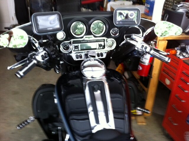

I've got a remote module for XM and GPS mounted with Mag Mounts. The XM is on the right side. The XM plugs into the Aux plug. My antenna is on the rear fender. Works great for me.

This is what I bought when I bought my new 2009 Streetglide. It's now in my 2011 TriGlide.
