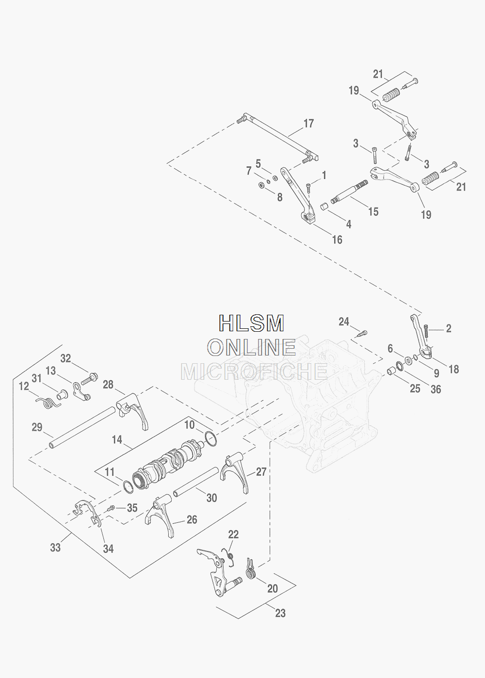

Look here, u have a hydraulic clutch, there is NO adjustment. The shifter lever on the tranny is a weak design, the lever comes loose, this Better lever does a nice job
Look at the picture below @ # 18
View image in actual size.
Open image in own window.​
View image in 100% of available space.​
GEAR SHIFTER ASSEMBLY

# 29 is the hydraulic clutch actuator, note the bleeder screw. You can pump the clutch handle 3-5 times, do not give it FULL bottoming pumps, in other words DO NOT pull the lever to the bars while pumping, use exact pumping, not fast, NOW use a Velcro strap or tape around the lever to the handle bars, Next open the bleeder , keep the left master cylinder full, cover up your paint, dot 4 brake fluid is hard on paint and chrome. After you bleed and top off and cover the cylinder IF your clutch does NOT work right, u may have a bad Master and or a bad Actuator and a worn clutch. I hope this helps. Harley has never fully addressed this issues IMO, I am working on an adjustment for our clutches, it is NOT overl expensive or hard to do IMO
