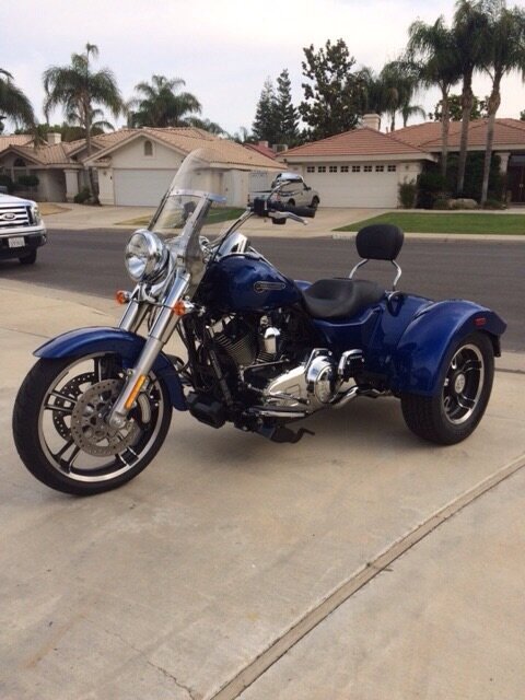

I am currently experiencing rear brake issues with my freewheeler. Bike is at shop.
I am currently experiencing rear brake issues with my freewheeler. Bike is up at the dealers to be fixed .
They have tried everything and when using the rear brake (which is linked to the front) the back right rear wheel locks up badly and pulls the bike to the right.
Technically since the front and rear brakes are linked via the rear brake pedal they should not do this. Also locks up enough to smoke the rear tire. The demo model that they had just started doing it as it got more miles on it but not nearly as severely. Apparently mine locks up pretty badly compared to most.
The tech people were called and ideas were exchanged . So far a solution has not been found. Was told the main HD corporate head trike tech guy retired recently. My question is:
Has anyone else experienced this problem and if so .
How did your local shop or dealership fix it.
?? Thanks for your time.

Brakes fixed: here was the problem.
Apparently the freewheeler is so new some dealers are selling them out the door with out doing a brake adjustment.
On the freewheeler trike there is an adjustment that dictates how much front and rear brake come on with the linked brake set up. On my bike this was way out of adjustment because the factory expected the dealer to set up this adjustment. Cudos to Grizzly Harley Davidson in missoula, montana for fixing this issue especially since I did not purchase my bike there. Turns out the brake adjustment is also a service item and is supposed to be adjusted so often at the proper service. So if your linked brakes start locking up badly and pull your bike/trike one way or the other take it in and tell them the brakes need adjusting. Bike is fixed and ill be going to get in on thursday. Thanks everyone for ideas and encouragement. I will be calling the dealer where I bought the bike and telling them they screwed up royal on my trike setup.
