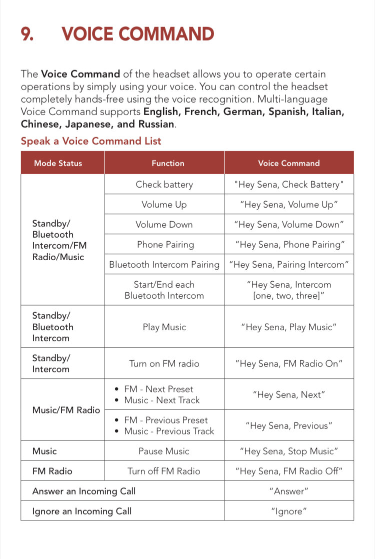

I would just like to know how to get SENA to respond to verbal orders... have brand-new SENA 50S units paired from the factory and she ignores me when I say... Hey SENA... and whatever I want to know .... like, "battery check".
I had the instructions printed into a nice spiral bound book... but the instructions themselves are NOT very on point.
At least I can now talk to my riding partner... and the audio is exceptionally clear I must say.
I have voice command on the 5S intercom units as well, and I found I have to speak up, and speak rather quickly for it to catch the entire phrase.
It might also have to do with the pronunciation of the trigger word SENA…(‘Senna’, ‘Seena’, etc.).
The instructions of course are in the manual which I’m sure you found… but I’ll post them here for anyone that’s thinking about getting one of these intercoms:
