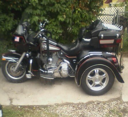

I promised I would post the result of my using the see through bra protective film from one of our sponsors so I will tell you a bit about it.
The folks at see through bra were very pleasant to deal with and kept every promise they made, the shipping was on time and the product is excellent, and they have a right to brag on it.

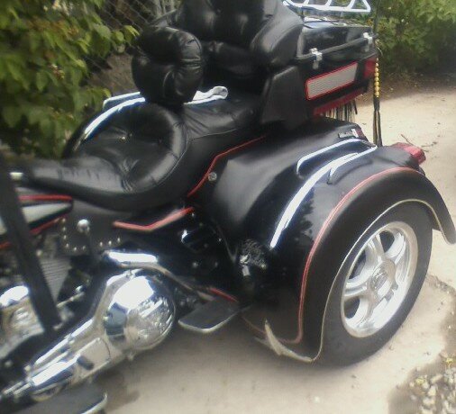

My experience has been that they did indeed laser cut the pieces to fit my champion trike and the film is tough as nails. I had to trim around my lower chrome pieces because I didn't want to take them off and I tell you that a razor blade was hard pressed to cut it.
The film almost seems to thicken when applied to a really tough finish that I think will be hard for rocks to damage.
The application process is allot easier than you might think also.
I would suggest that you clean the paint with the application fluid first, spray down the entire area to be covered on your trike, spray your fingers(keep them wet) and liberally spray the film after being removed from the paper backing before applying.
Start at the top of the fender and use the application squeegee at a 45 degree angle to remove air bubbles. The film is pretty forgiving so you can lift it and spray more fluid under it as you go should you need to.

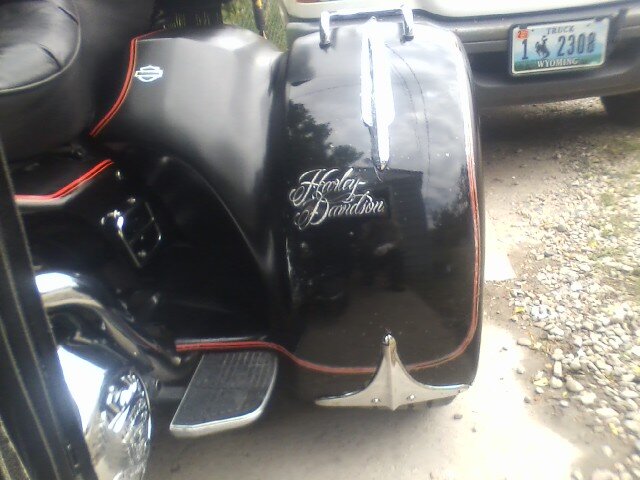

The end result is a deep looking beautiful clear finish that is very reflective as if you had used many clear coats.
I wish I could do the entire trike body with it.ThumbUp
I WILL LET YOU SEE THE RESULTS, AS OF RIGHT NOW I HAVE ONLY DONE THE FACE OF THE FENDERS BUT THEIR PRODUCT INCLUDES LASER CUT PEICES TO PROTECT THE PASSENGER FOOT WELLS AND THE AREA BETWEEN THE SEAT AND THE FENDER TOTALLY PROTECTING THE FRONT OF THE TRIKE BODY.
I don't care much for the 3M spray film product and took it back off my trike but this film is all it's supposed to be.
