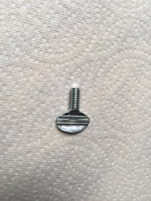

Having my tour pak leveled and relocated aft 1.5" with the tglidestuff dot com rails makes getting to the seat screw very easy. The simple thumb screw solutions seem like an easy solution. Thanks.

Great idea!
Glad I'm not the only one who has trouble with that damn screw! I like your idea, I'll give it a try. They only thing I found that helps me is I use one of those screwdrivers with the spring clips that hold the screw in place.
Thanks again.
