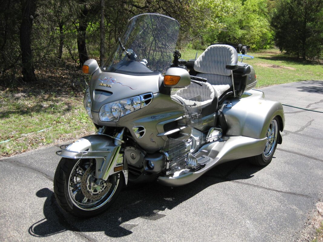

Once I changed to F4 windshields the scratches are now no longer a problem, you'll notice I now have a windshield wiper the same as F4 uses on their display model F4... not a scratch yet!! Just FYI

Going on (7) Years for my F4+4 and it has had punishment. Recently applied some more punishment and its working very well.... as I was told it should per F4 owner!!
