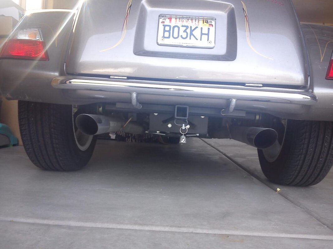

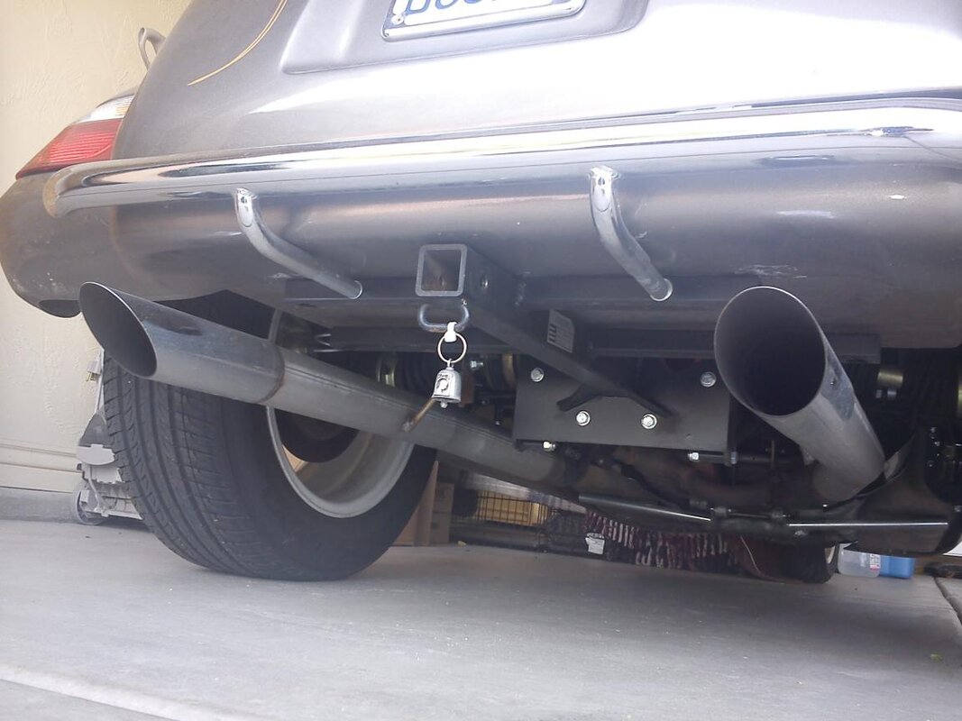

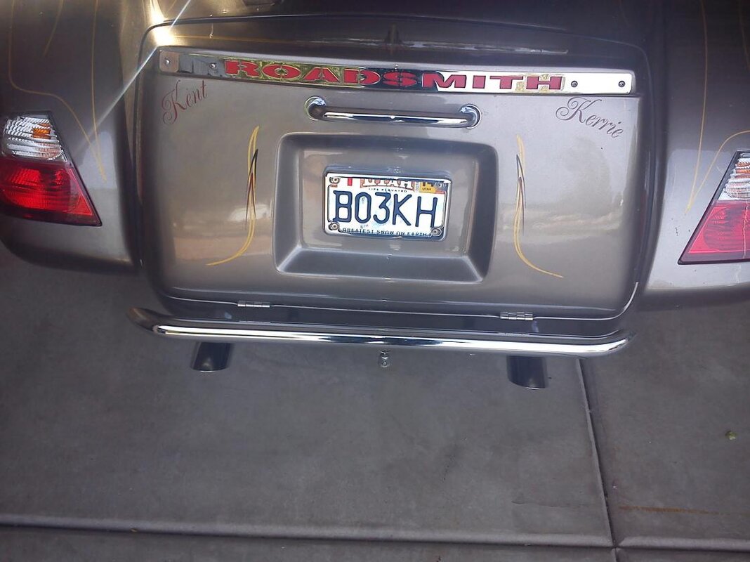

Rick, here is what mine looks like. I like the old school look, same as the pin striping.
I've also added a handle, first pic, on the trunk too.
Rick, you can extend your stock back past the RS bumper. I did it to mine before I took the mufflers off.
I hope you can follow the pics.
I put two supports going from the RS muffler mounts to the front of the "H" frame. and mounted the mufflers to that brace. Then you will have to take it to the muffler shop and get an adapter pipe from the RS extension pipe to the muffler.
