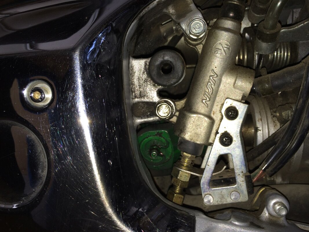

Brake recall
In my owners manual it says the driveshaft should be greased annually. Today I talked to the Honda dealership service manager that did my conversion to make sure on the brake recall and After finding out the Roadsmith didn't need the recall I mentioned the next time was in i wanted them to grease the u joints on the driveshaft and he said they never needed to be greased again, do I go with the manual or the service manager.
My brother just had his 1800 Roadsmith in for the brake recall and the dealer replaced both master cylinders. Mine is going in on Wednesday for the same thing. They apparently have made a change to the rear master cylinder, so it should be changed no matter what.
Called two Honda dealers and both said that the Roadsmith did not need the recall, My ADV is disabled on mine when I did the race tech springs and gold valve kit. I did take mine in and had the clutch and brake system flushed, also had them document this and send into Honda.
I am no means a mechanic so I called my local Honda dealer about the recall. They told me yes, it needed to be looked at. After all said and done, they told me they replaced the 2 cylinders. I feel a difference in braking..and like the change.
