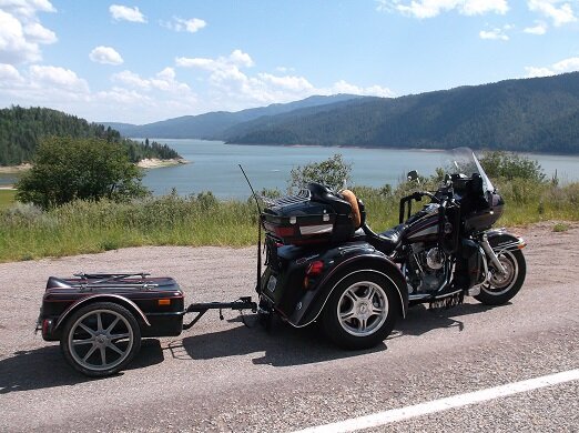

personally I would trade for the new triglide which is what I did. I spent 15k on a motortrike irs kit and sent the bike to texas and had the professionals install it LMAO
3 rear ends 2 belts and a compensator I traded for a TriGlide 2014. These have been the happiest days of my lengthy trike history not to mention cheaper and have warranty bumper to bumper. The belt on the roadglide are not heavy duty enough. Its only a 1 inch I think and the gearing would be 32/68 as apposed to 30/70 which is why the belts and rearends didn't preform. You will have many dollars spent to make the rg preform like the tg and the tg is standard. Kind of a no Brainer.
blutru I had a 2007 that I made into a RoadGlide/Champion. Rode her for 4 years and 60k miles. Loved it. Since September I now have a TRI-Glide. Just turned 13k on her. Love them both. Both were straight axle. On both I have gotten rid of the air shocks and and replaced them with standard coil over shocks. Ride has been great on both. I do only ride solo the wife has her own Stallion trike. I weigh 220 and carry a full tour-pac and trunk. TG vs Conversion have a lot of plus and minuses. PM me if you want to set up a phone call.
I was in a similar position to yours; I loved my 2006 FLHTI, I had owned it since new, personalized it, and it had no issues or problems. I looked at kits, and really liked the CSC and Roadsmith conversions. The deciding factor was the installer. My local Harley dealer is a CSC dealer, and did the conversion for me.
As you can see, I favor the IRS over a straight axle, like the TriGlide. That's a personal preference. I also liked the styling of the CSC a tad better than the Roadsmith. The money on trading and buying a new TriGlide was the same as converting my existing bike. Many would prefer the factory warranty, but, as I said, I knew the bike very well, and had no qualms as to its longevity. I also like the wider stance and extended wheelbase of the conversion better than the TriGlide. I feel it gives a better ride and handling. Also, during the conversion process, I was able to customize to my heart's content, powdercoating and painting many pieces, as well as upgrading the power on the motor, and adding a mechanical reverse. I feel I came out ahead money-wise, as the TriGlide would have been a blank slate, so-to-speak.

I love my Roadglide with a Motortrike Trog kit. Had a batwing fairing for 15yrs. The Roadglide fairing makes riding the trike less physical because the wind is not pushing on the fairing.
Plus I like the look of the Roadglide.

I purchased my 1989 Harley tour glide ultra new and have kept it all these years, Basically because Harley quit making the tour Glide and it was my favorite of all the Harleys.
They came out with the road Glide and I found myself in a position that I could not afford a new one because I am on a fixed income.
I would have kept that old tour Glide regardless.
Two winters ago Bazooka (forum owner/administrator) helped me to find a conversion kit that would fit a bike as old as mine, The choices were Champion and Frankenstein.
The Champion kit had a much cheaper initial investment than the Frankenstein and I have to admit I like the looks of the champion much better. (to each his own, there are lots of quality kit manufactures out there, the trick is to purchase quality to begin with)
Zook got me a substantial discount on the kit and champion delivered it to my door which some manufactures wont do.
I also bought a 5 degree raked triple tree from zook (hog halter brand) at about half the cost of other manufactures and the tree is real quality.
I did the conversion myself and as a result I have around $8,000 total into building my trike. Please understand that the quality of your trike depends entirely on the integrity of the builder, doing it myself gave me complete control of quality.
I am a fair bike mechanic but by no means a factory certified tech.
And folks on the forum were free with tech. advice when I asked for it!
Also Zook and champion went out of their way to help me with any questions I had.
The tires are exact match for the tri-glide.
I went with the straight axle kit because it is the most straight forward and simple set up to do yourself, Also the tri-glide is a straight axle and if it was good enough for them I reasoned it was good enough for me.
I will admit it rides a little rough on our city's crappy streets but when I get it on the highway (which is what I built it for) it smooth's right out and is a pleasure to ride.
I have a friend with a tri glide and my trike rides every bit as good as his, has more rear ground clearance and steers much quicker than his, also I have the huge fairing that the batwing style just cant compare with for protection from the elements.
In short, I like it better than the tri-glide!
