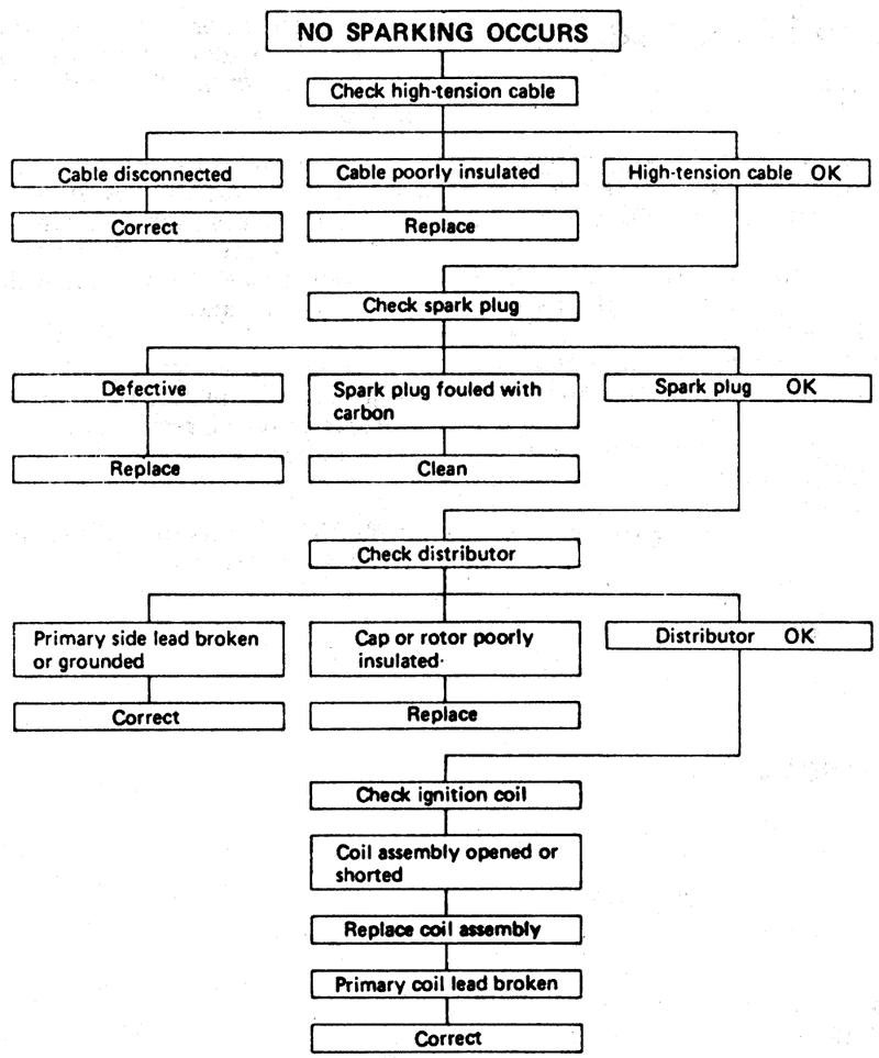

To help with diagnosing technical problems there are charts to guide you through the problem. Asking others also helps with ideas of what may be the issue. Example of a typical chart below.
