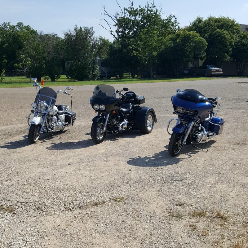

Went for a 250 mile run on Saturday with my Lady and two other bikes riding 2 up.

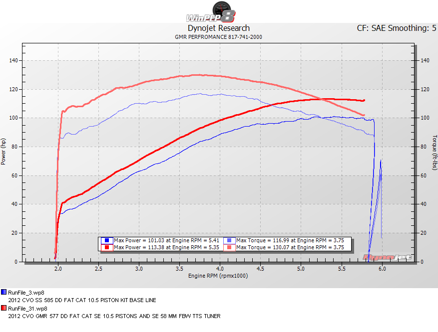

To really get a feel for a motors power calculate the motors average TQ from 2500 RPM to 5500 RPM, that's a far more important # than Peak TQ
a 110 build from Steve @ GMR 2012 CVO, 577 cams, D&D Fat Cat, 10.5 pistons, 58 MM TB, TTS Tuner

So, now are you going to change your name to 'Fastride'?

Funny, I do believe that's from my bike's dyno run!
"ALRIGHT" Lostmutt...Did Steve @ GMR do your bike and if so...please give us a first hand accounting of how this bike runs and is it the stump puller we think it is?
Yes he did. I'll try to upload the dyno sheet tonight from my laptop. I had my solo seat on (instead of my 2-up with backrest) and when I rolled the throttle for the first test ride I didn't have a great grip and damn near slid off the back of the seat! LOL It's a lot of fun to ride!
