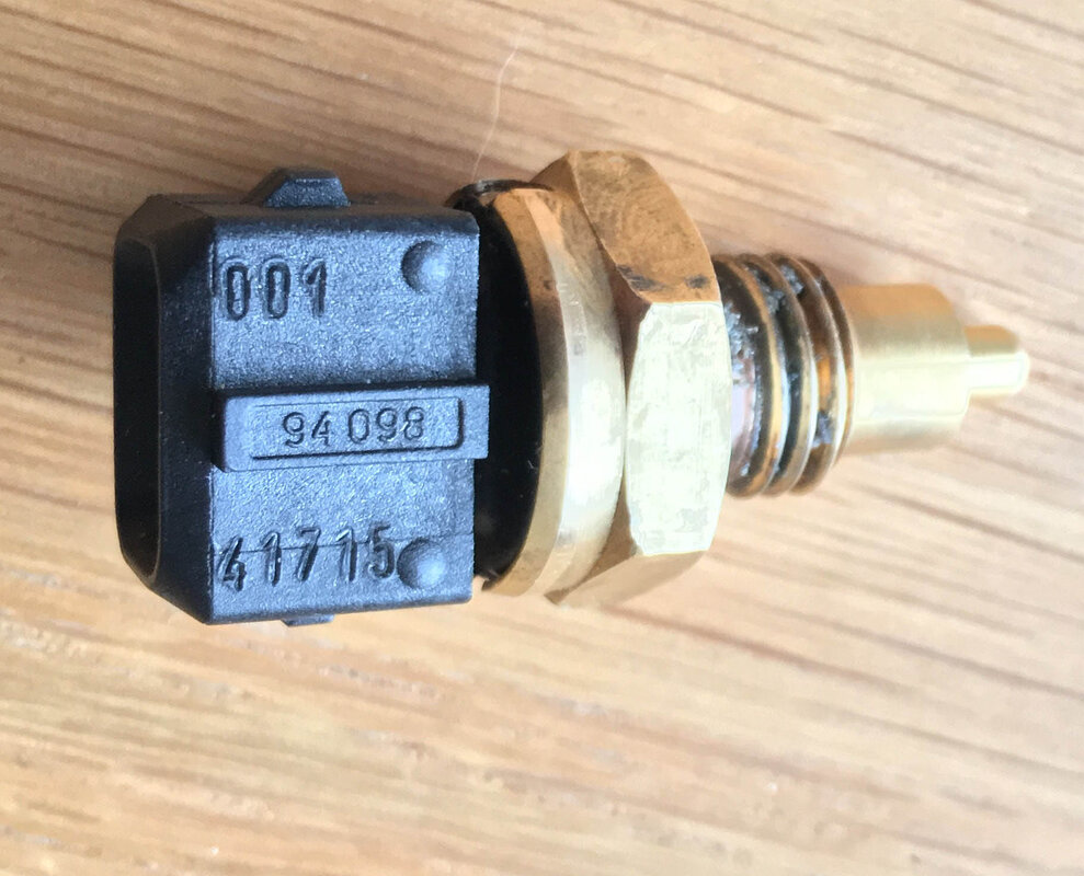

Can you post a picture of it?

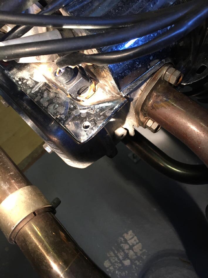

Trike is an injection, I have attached images of sensor in and out of the trike.
As previously mentioned I physically broke this trying to remove it, before I broke it the trike was very difficult to start when cold, with the sensor out of circuit (plug removed) would not start at all, whilst it may transmit oil temp to the gauge I also believe it gives temperature information to the fuel injection ECU to help it determine the mixture require to start depending on temperature. (I may be wrong, I am not that familiar with fuel injection).
Either way it is definitely open circuit now so before I can continue I need to replace it.
thank you
ps. the pictured sensor was replaced by previous owner a short while ago, I am pretty sure that whatever the technical spec is that it is not the same as factory supplied. Also component shown is made by AB Tektronik, I have contacted them and this sensor is not available any more and they can't offer a direct replacement, my search continues for a factory fitted replacement.

-as a last resort, if you have some electronic skills, I would try to find that good value. Basically that sensor is a thermistor which must have a certain ohmic resistance at 25 celsius temperature and most probably you have the wrong type. Other parameters may be less important right now. You can measure the resistance of this sensor when everything is at room temperature and procure several resistors with values near the value of the thermistor you have. Let's say your thermistor is 100 ohm at 25 celsius, procure resistors of following values: 33 ohm, 47ohm, 120, 180, 220, 270, etc. Connect them in circuit and see where your engine starts (from room temperature, don't let it get hot) better. When you find it, you have a reference for the component you are looking for. Of course, I cannot assume responsibility for this procedure, it is just a suggestion.
le: I see now the nominal resistance for 94098 is around 2.2kohm. You can try with the following values: 1k, 1.2k, 1.5k, 1.8k, 2.4k, 2.7k

I did get a reading from my previous sensor before I broke it, it was cold but could not say exactly what the temperature was, anyway I measured 4.5Kohm, took out the sensor and warmed it a little in front of a bright halogen and the resistance changed to 1.8Kohm. I deducted from this that the sensor was working but as previously stated I believe it is not the right part and the value range is not the right spec for the fuel injection system.
