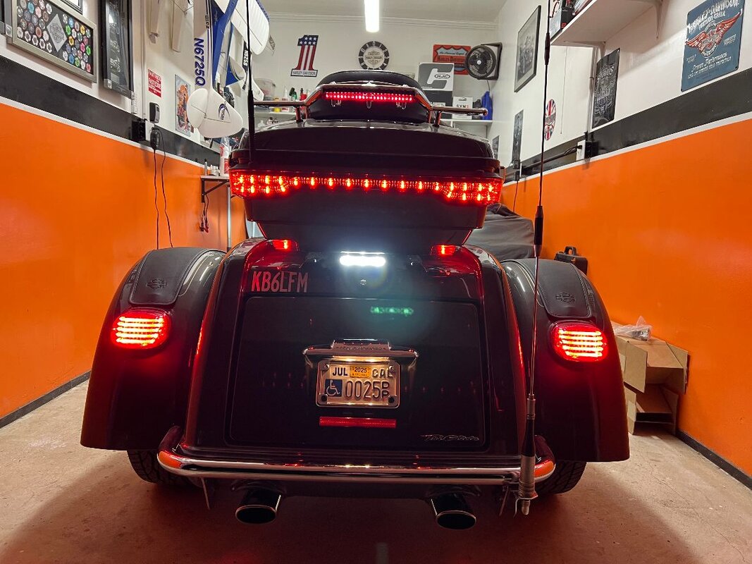

Bike here is a 2023 Tri Glide Ultra. Other years could apply. This IS NOT a kit, and these 2 parts were the only ones that were available. I purchased the parts from my HD dealer.
HD part numbers.
LIGHT, LIC PL, REVERSE-------67900430
BRKT, LIC PL, LIGHT COVER- 67900433

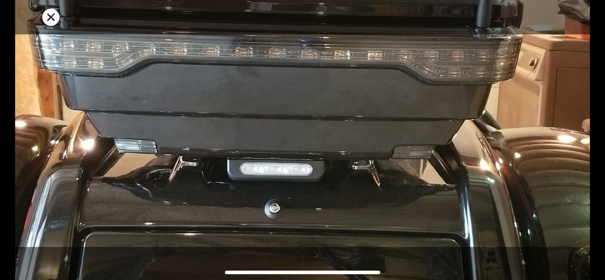

The light has a 2ft wire with a connector that plugs into the reverse light pig tail that is located between the tour pack and the seat (the seat does not need to be removed) To mount the light, I super glued the top of the light cover to a 1/8" thick 6" X 1" piece of black plastic. Then I attached a piece of 3M double side adhesive tape to the other side of the black plastic. This light is mounted to the bottom of the tour pack by the 3M tape. (see attached photo)
