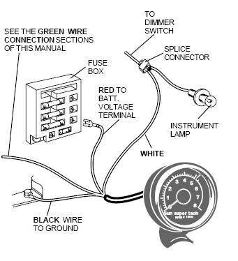

I want to fit a tacho to my trike, i bought one from Ebay but could not get it to work, there were only three wire live & ground plus a green one that i thought would go to the electronic ignition to pick up the pulses......but no.

I've always kept mine simple. Red wire to the (+) side of the coil, Green wire to the (-) side of the coil. Third wire is usually either a positive for the light or a ground wire as you indicate yours is. (If third wire is a ground then light positive power is pulled internally from the Red wire). A fourth wire would be required to make the light dimmable.:xzqxz:
Generally the red wire feeds the 12v positive (+) input and the green wire will feed pulsing negative (-) input so traditional tachs would work off just those two feeds. Wires beyond thos two were for light(s) or additional functions.

I did have it wired the way you describe but it did not work. I sent it back and got a refund. I have however got the engine running as sweet as a nut, ticks over like a baby, pickup is clean and sharp. I just need to get it taxed at the end of this month ( a UK formality otherwise known as a royal rip off)
Bit slow with the reply as i have swapped to a Mac and havr had a bit of a learning curve lol. I did have it wired the way you describe but it did not work. I sent it back and got a refund. I have however got the engine running as sweet as a nut, ticks over like a baby, pickup is clean and sharp. I just need to get it taxed at the end of this month ( a UK formality otherwise known as a royal rip off)
