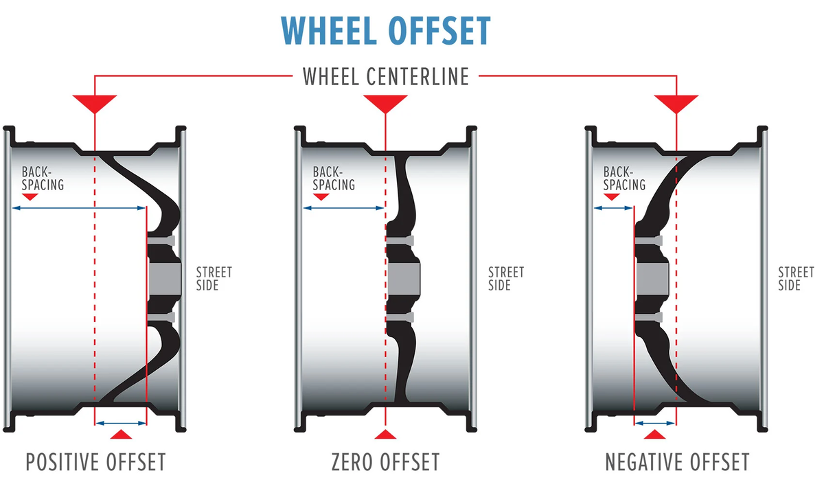

But besides the size and the bolt pattern, you have to pay attention to the offset. The offset is basically the positioning of the center face of rim in relation to the round outside of rim if that makes sense. If you get the wrong offset, the rims will mount and be too far in or too far out. Normally you can find the offset of your rim stamped into the back side of rim somewhere. This explains offset a little more

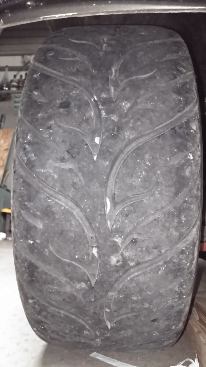

As others said, we have CUSTOM trikes. so have fun! I went from the original 225/60r15 BF Goodrich car tires to Federal 595RS-PRO 225/45R15 rain race tires. . Absolutely satisfied with the results. Installed 5 years ago. Grip like they are glued to the road, INCREDIBLE wet performance, and good wear so far! The reduced gearing really helped also.

IE: the backside of the wheel that sits against the axle is equidistant from the inside and outside of the sidewalls. The flat part you CANT see with wheels installed.
Positive offset is what you see in most newer cars, along with zero. The 'deep dish' rims are a negative offset. A 15x7 rim with 4" negative offset would have the lug nuts VERY close to the same plane as the sidewall. NO backspacing.

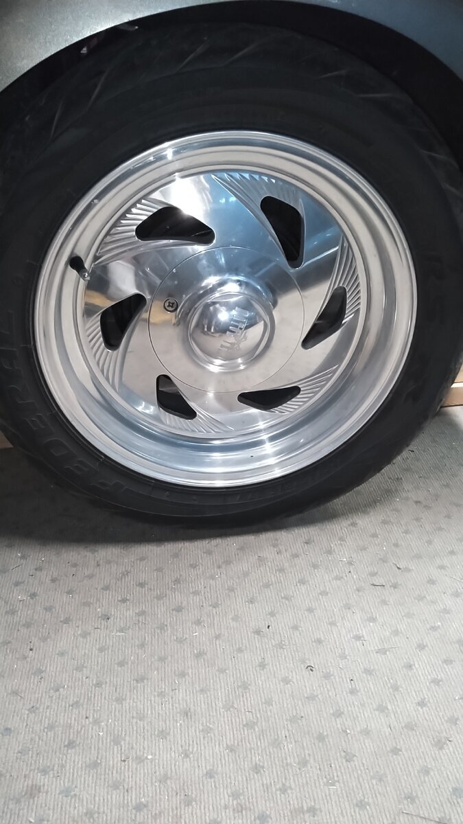

My setup:

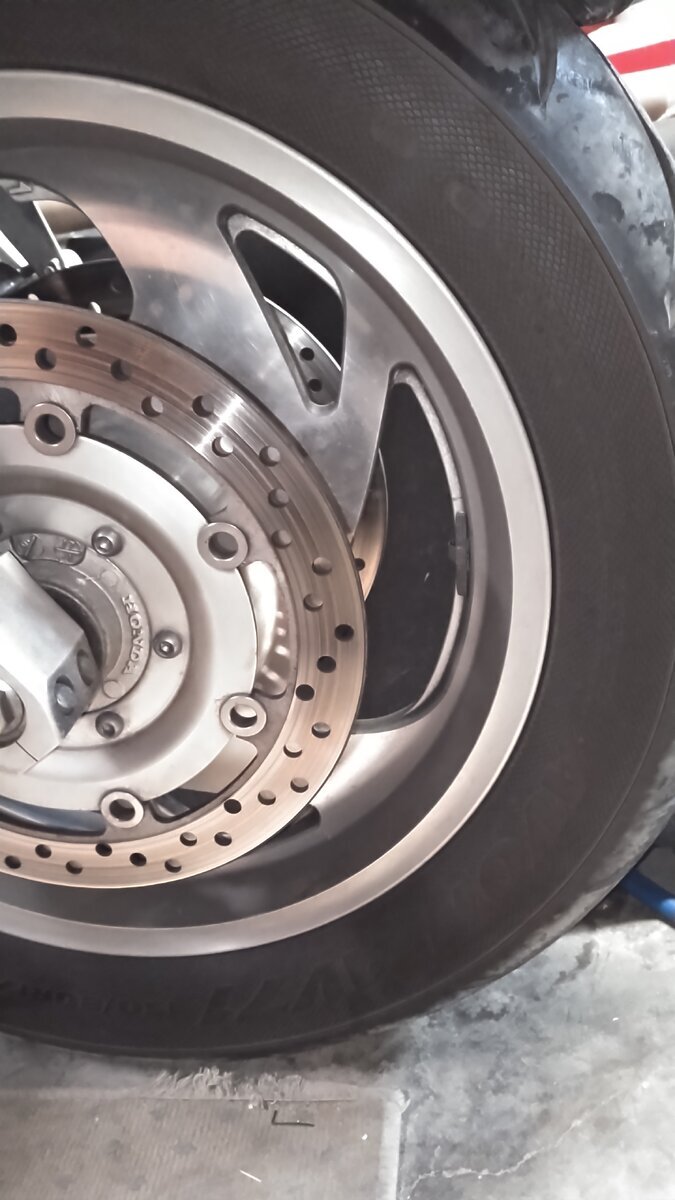

The cutouts on the front wheel(stock VTX 1800C) are echoed in the custom back wheels, along with the added 'speed lines'. The center cap is obviously custom for Motortrike. Had a machinist friend guess the rears were billet rims from looking at the front face of them while mounted. Plus they polish up well, and hold the shine.
I questioned the same machinist about adding the 'speed lines' to the front wheel. He stated that the front wheel was cast, and most likely would not take a polish well after machining. He suspected that the previous owner had the front wheel sanded and polished. I know polishing the front wheel is ALWAYS on the to-do list. :cautious:
I absolutely LOVED the tread pattern. Grips like a gecko in the dry, and excels in the wet. And leaves the most awesome tracks.
