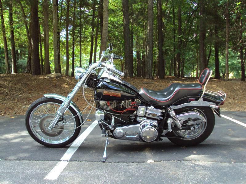

How about using the frame downtubes with a 3 piece clamp and mounting it similar to a Shovelhead wide glide

Horn bracket bolts only, in years gone by it used to be an upper engine mount;)
Remember your Trouble head ( Shovelhead bike) ?
M8 engines have the upper engine mount on the front of the engine, some of these bolts like to loosen and shear off, mostly on triglides and baggers. Go figure
