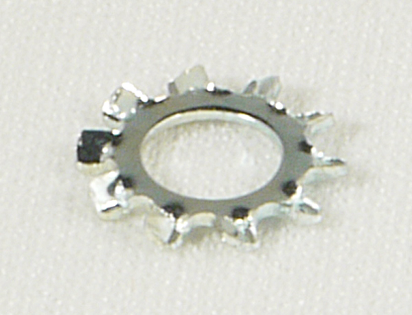

Make sure you have good clean and tight connections, make sure you have GOOD grounds including the regulator, if need be scrape a bit of paint off the mount and use grounding washers as needed
