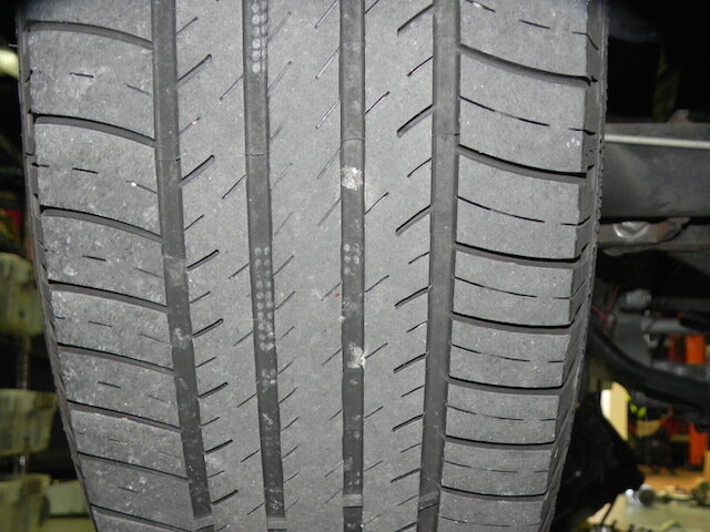

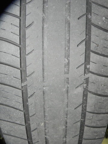

Here are some pictures of rear tires on a trike that is in my shop now. Obviously, his tires need replaced. The right one is worn well below it's wear bars and the left one is worn to it's wear bars. These tires should have been replace probably 20-25,000 miles ago.

My right is a bit more worn then the left but not terribly at 27K miles. Ive obviously never switched them around. Ive always been of the school of front to rear on the same sides OK with 4 wheelers. But not left to right/right to left as on a trike????
