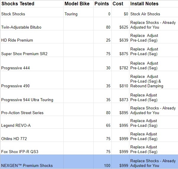

We tried several different air shocks...one pair was for a Corvette. We had folks report that they worked well. We did have to do some modifications.
They did work a bit better than the factory air shocks, but not enough to make it worth the change.
There is an option that provides a significant improvement, I used them for tens of thousands of miles and they are a BIG improvement over stock.
They are just over $500, so well below the $1k pain threshold.
You can see some details on them HERE.
Below is a comparison chart of different shocks-
Here is a LINK to a Complete Report on Rear Suspension.
