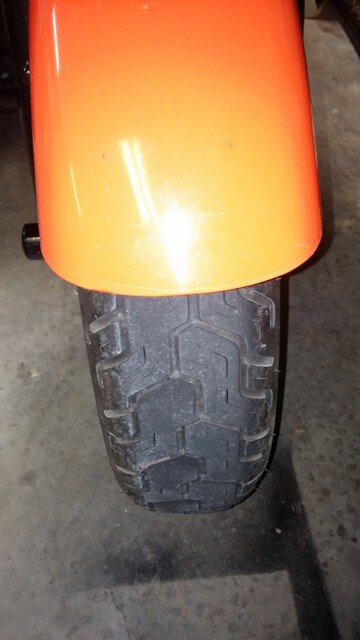

Dunlop MU85B16 rear tire mounted in reverse 30k miles. Enough said......

My next front tire will be a Dunlop American Elite rear tire mounted in reverse.
The directional arrow on the sidewall of the tire when installed in reverse the wheel valve stem will be on the right side as you sit on the trike.
I have 19,000 plus on original front tire.As I sit on the bike now the valve stem is on the right side and the directional arrow is on the left side pointing toward the front . When I replace the tire with a rear tire the valve stem will still be on the right side and the directional arrow will also be on the right side pointing to the rear as I sit on the bike.IS that what you are trying to tell this Dummy???????? Thanks for your help

While I cant respond to the use of a rear tire mount in the forward direction on the front I can state this as to running it mounted in reverse:
"In 30k miles I have ridden in wet weather and dry, pushed my trike into corners faster than normal. Not once did I have a moment of traction loss."
