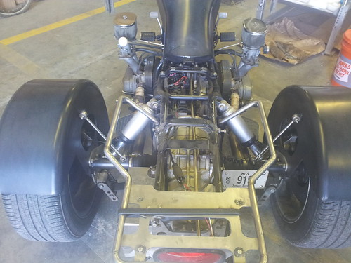

I sandwiched a bracket between axle flange and plate on the three bolt mount.
I on the phone but will try to post a pic.

Mounts on Axle flange.
