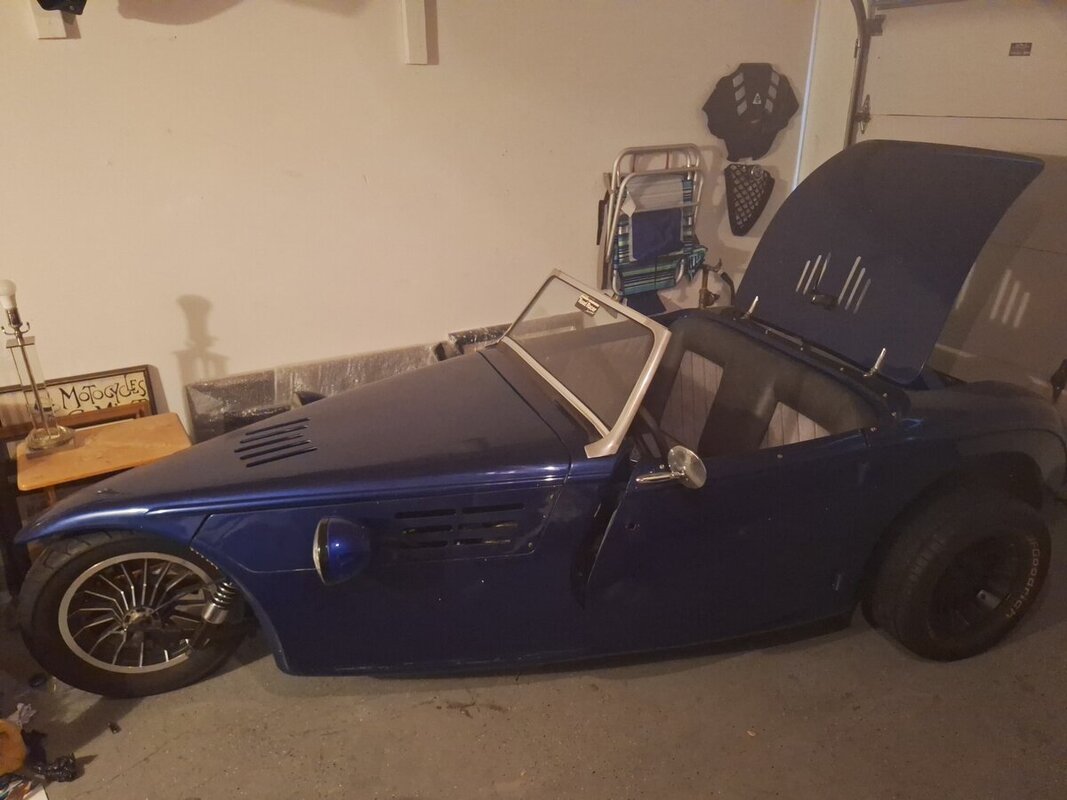

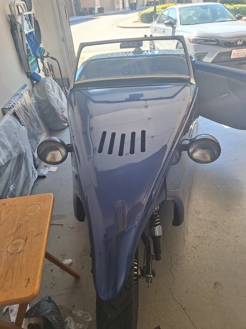

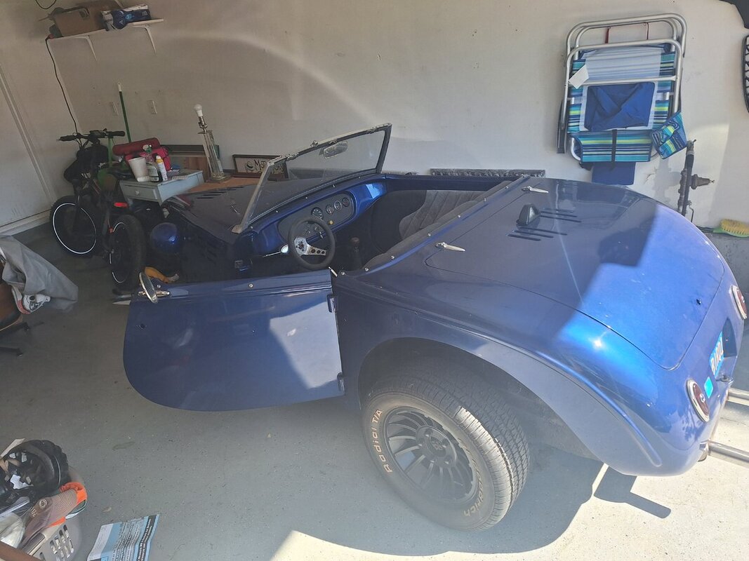

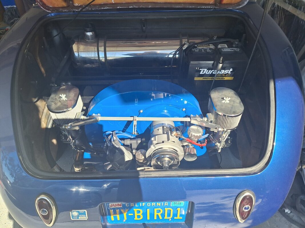

Howdy CH701builder
Here's a picture of my pop's 3 wheeler
Hopefully it helps
