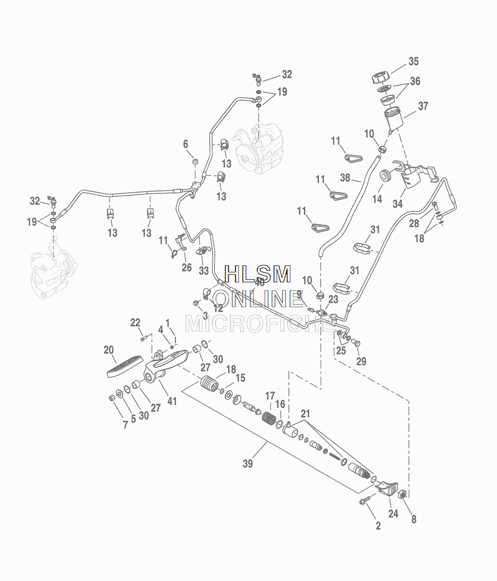

Bob is right, take a look at this parts diagram and you will see it part#23
It"s really easier than it looks. 2 bolts on the master cyclinder and remove the nut holding the pedal on and you can wiggle it out and forward. Enough to get the switch swapped out. I will agree it's a lousy place for them to put the switch.
