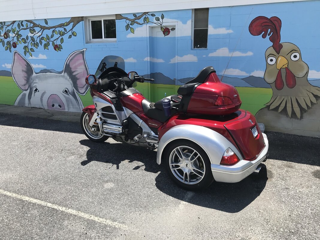

Dear experienced riders:
I wonder if any of you have switched over to using the rear brake almost exclusively.
I have a rare muscle disorder and my hands tire quickly. For example, my wife and I rode to Mount Mitchel yesterday. Lots of switchbacks and elevation changes. My throttle/brake hand got tired and recovered several times till I was nearly home. Then it became very weak and slow.
A lot of that is from holding the throttle, but it is also from using the front brakes. I have cruise control, but that won’t work on country roads and mountain switchbacks. I have a throttle rockers, but using it means I can’t push on the bars as well, especially on left turns. So, my next idea is to stop using the front brakes and try using just the rear brakes. I am no racer and mostly ride pretty close to the speed limit.
Feedback? Suggestions? Stories?
Thanks.

I ride a Roadsmith Gold Wing. I came with linked brakes from Honda. They had to split the brakes when they installed the trike kit. I don’t think they can be linked back up. I wish.
I am going to get out to an empty parking lot, and some back roads and see what the trike will do rear-brake only. I will report back after that.
My understanding is that Roadsmith has made kits both linked and not. If you yours isn't it would be worth some phone calls to both Roadsmith and some reputable Trike shops. Also keep in mind only part of the pistons are applied when using the rear pedal. The rest with the lever.
I have been riding for more than two weeks using rear brakes ONLY. I still cover the front brakes and sometimes use them to hold the bike at a stop. However, I am using the rear brakes almost exclusively.
This technique works freaking GREAT!
No issues at all. Plenty of braking power. Zero brake fade. Excellent brake feedback and feel. When I brake hard with the back brakes, then add the front brakes hard, there is virtually no difference in stopping power. Would I use them ALL in an emergency? Sure. Why not? My hand is right there anyway, so what the heck?
Now, I started this because I was losing strength in my hands on long rides. Not now! Not at all. So, in that sense, this technique is way WAY better and safer FOR ME.
I am very pleased, see no downside and will continue to ride this way.
