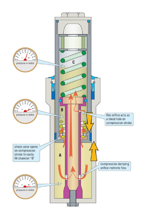

Like most folks, your assumptions about shock oil longevity are wrong. Yes forks are shock absorbers, but the oil itself is the dampening agent. Without oil, it would be like riding on a pogo stick. Dampening occurs when the oil gets pushed through several small holes or orifices in the dampening tube upon compression and sucked back through these same holes when the springs recoil. The friction and pressure of the oil constantly being forced through these tiny holes gets the oil very hot.
If you dont believe it, take a 20 mile ride and drain the oil and it will almost burn you. That heat breaks down the oil and will change the viscosity and your forks will work less efficiently for suspension and braking. Fork seals also break down over time and allow moisture in thus further contaminating the oil.
Ive seen 50K mile fork oil come out black as soot.
What most dont consider is that pressure causes heat.
This is the principle that the diesel engine is built upon. The pressure is so great in a diesel engine that no spark plug is required, the pressure causes the ignition. Obviously shocks generate no where near that pressure but they do cause enough to generate substantial heat.
