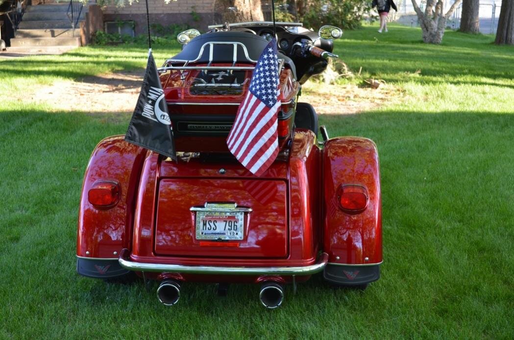

They make a monster oval just for the trikes. I have the monster rounds on my trike without any problems. Love the sound !
Attachment 17301
I wish I would have found monster rounds.
From what I hear they sound pretty much the same, but would actually fit.
