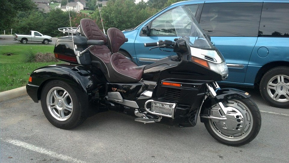

Here is a pic of mine.I don't have a better angle of that area but you can zoom in and get an idea.I didn't have a problem while riding but the protectors would hit if I hit a dip with the wheel turned. It had Progressive springs at the time. i switched to a standard spring, which raised the front up some and never had a problem. You could also remove the protector if that was all that was bothering you.

Here is a pic of mine.I don't have a better angle of that area but you can zoom in and get an idea.I didn't have a problem while riding but the protectors would hit if I hit a dip with the wheel turned. It had Progressive springs at the time. i switched to a standard spring which raised the front up some and never had a problem.You could also remove the protector if that was all that was bothering you.
Nice looking trike Marc, the protectors would have to go for clearance in my mind, maybe a fork brace also an option? Much to consider.
Mine had a fork brace on it and it sits flat with nothing sticking up. The only time I noticed the protector hitting was parking lot situations. Turned very sharp and on uneven ground. Remember it will traveling the same angle as the forks not straight up and down so it will clear unless your turned sharp.
Here is a pic of mine. I don't have a better angle of that area but you can zoom in and get an idea. I didn't have a problem while riding but the protectors would hit if I hit a dip with the wheel turned. It had Progressive springs at the time. i switched to a standard spring, which raised the front up some and never had a problem. You could also remove the protector if that was all that was bothering you.
With the proper fork springs, so long as they are not weak or partially collapsed it should not be necessary to remove the fork tube protector shields. Marc noted that on his 6 degree rakes GL1500 when he replaced his old fork springs with new Honda stock springs he never experienced the bottoming out. Over time fork springs can start to collapse especially after the bike has been converted.
I would suggest that if you have not already done so, replace the fork springs with new stock Honda springs and leave the protectors in place as they keep bug gut splatter off the lower portion of the fork tubes which preserves your fork seals. Dried bug guts are like sandpaper and will ruin your fork seals.
I would suggest that if you have not already done so, replace the fork springs with new stock Honda springs and leave the protectors in place as they keep bug gut splatter off the lower portion of the fork tubes which preserves your fork seals. Dried bug guts are like sandpaper.
