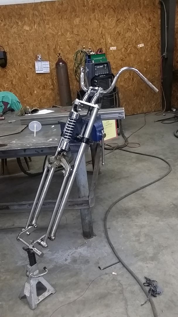

And what my stainless steel front end is looking like.
Well I do have rear suspension.*
I don't really know if mine would be called a springers. It does have a hydraulic shock for dampening instead of rebound springs.

Very good looking girder. Question: I have done a lot of research and the lower rocker on a girder or springer seem to have no standard position. Some seem to be set high, more pointing towards the top of the tire or at least has an upward slant. It seems that very few pics I have seen have the rocker(? is that the right title) parallel with the ground. It would seem that parallel with the ground would give it the most functionality and proper handling? The rake of your pic of your forks in the vice shows the rocker parallel or close to it...
I set my leading link up with link parallel to ground but pivet pin center location is lower than axle center location.
First, it is not a girder.*
It is a leading link I suppose, because of the hyd shock.
Just made to look like a springer.
It is a drop axle rocker. It is not in the loaded or finished position at all. This is just a mock up. Once the scooter is together I will trim the length of the rods to position the rockers where I want them.
No there is no set length or shape to rockers or leading links.
The part that is set is where the axle is in relation to the neck.
A girder has the spring and links up top at the trees. No rockers at the bottom at all. You set the geometry at the links up top. The legs of a girder can be any shape you want as long as the relationship of axle to neck is correct.
Go to the links I posted. Read up. It is all there.
