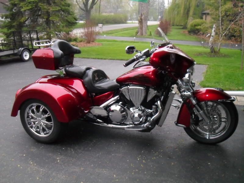

6* sounds like a lot (?) did it make the handling squirrely at all?
I can wiggle the handle bars going 60mph and the bike just wiggles. Does not get crazy at all. But does changes lanes quickly. Very cool effect.
I would think 8* would be to much, but that's my opinion. Does handle very nicely in parking lots at slower speeds.

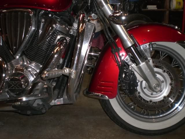

Side shot
Before shot

Did you (or anyone for that matter) need to add fork extensions and handlebar risers after you raked it? Would the head light adjust, or did you need to buy a special bracket to compensate?
Re: How much rake on a Trike
I didn't use any spacers. With the change in distance from front to rear tire it was a push. I did have to adjust headlight a touch but not much. I went to a lower riser but mainly due to the fairing.
