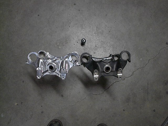

First of all, welcome to Trike Talk and the three wheel world. I am sure you will enjoy both.
The easiest way to tell if a GL1500 or 1800 has a rake kit installed is to look at the triple trees. If they are milled aluminum you have a rake kit. OEM is steel painted black. If you find no rake I strongly recommend doing it. Our founder (BAZOOKA) has sold many of us kits for very reasonable prices. I personally have installed several of them in my friends trikes. They are top shelf kits!!

Without a rake kit the front acts like a "long caster". Like when you push a Walmart buggy across the parking lot that's on a side hill grade, it constantly wants to fall off to the low side.
Rake kit will halve that caster's length by moving the front wheel contact closer to the steering axis at the ground. It'll remove much of the pull you feel and feel like power steering. 6 degrees is good on a GL1500 with Lehman GTL kit.
On left is Champion 6 degree EZSteer kit in 2004, on right is stock GL1500.
