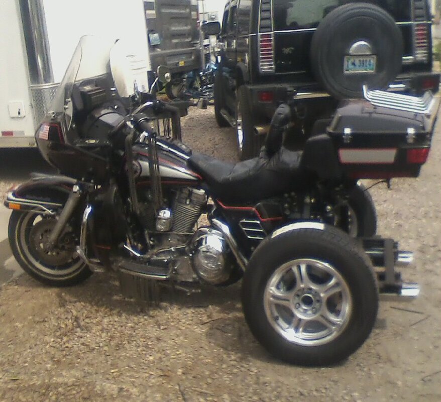

Nice bike :pepper: mines a Harley too, and with my Champion conversion, 6 degree rake and independent suspension I can keep up with my 2 wheel buddies, going to the Dragon this spring.ThumbUp

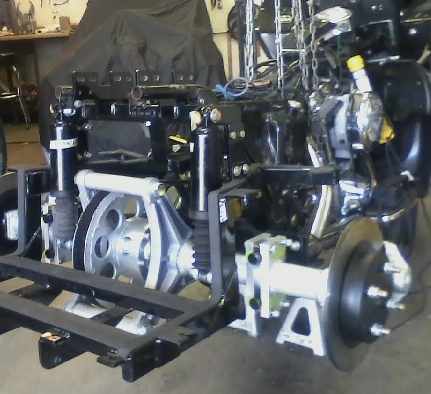

d-11-readytomoveontobrakelines_zpsc11be625.jpg rear trike assembly. take wheels off! support on frame with jack stands, not the axle.

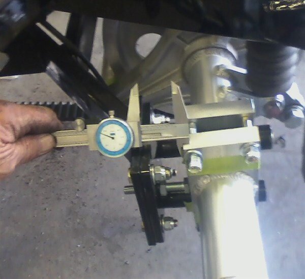

d-8-usingadialcalipertoadjustalighnmentonaxleanddrivepulleys_zpsfd2f8067 (600 x 548).jpg These are your alignment blocks, use a dial caliper to check each side of axle, I got mine within one thousands of an inch.

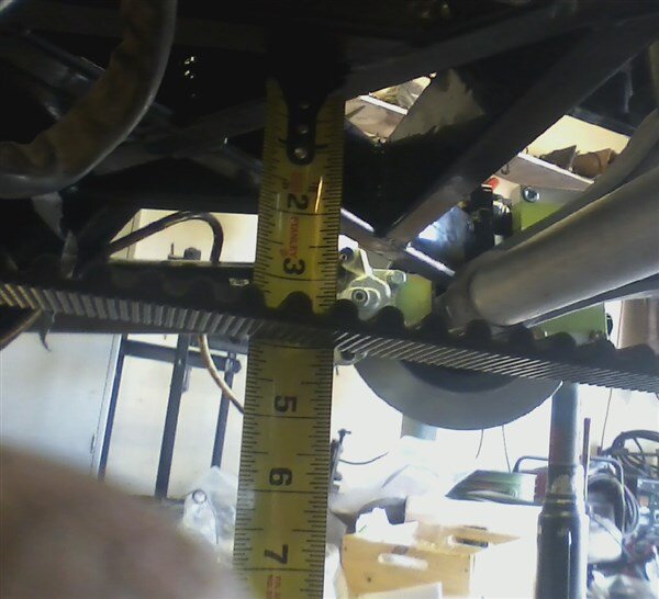

d-7-checkingforbeltplay-oneandahalfinchplay_zps58475571 (600 x 546).jpg check your belt tension, ( with axle hanging down) you should have 3 inches play, with it on the ground with the wheels on it should be 1 1/2 inches play(at least that's what it is on my Harley. make sure you torque every bolt.
