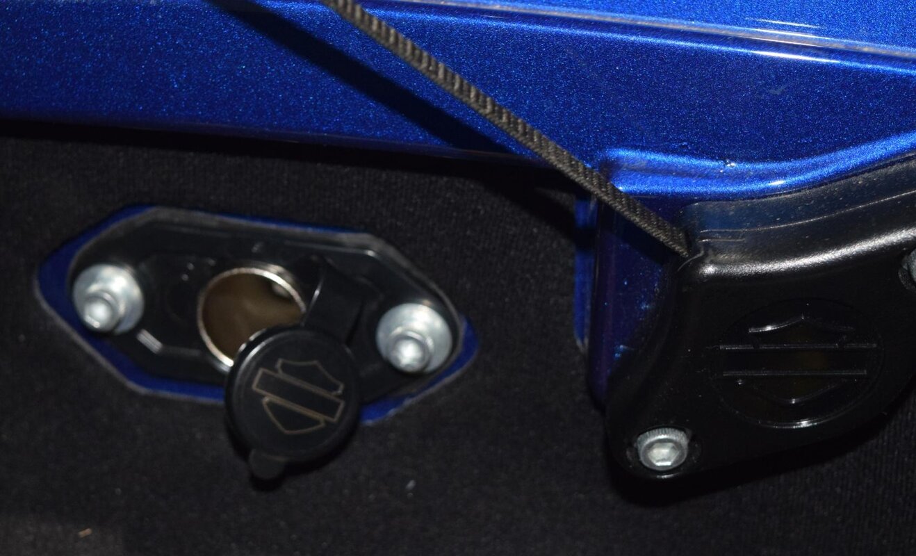

Another quick and clean way to add 12V power to Freewheeler trunk area. Harley part number #69201099
1) Review and adapt HD instructions for part number (contains "warnings" that may apply to some)
2) remove plastic plate in trunk, drill 7/8 hole and install socket, route cable under seat and ty wrap as needed
3) plug into aux socket under left panel
4) reinstall plate and socket,

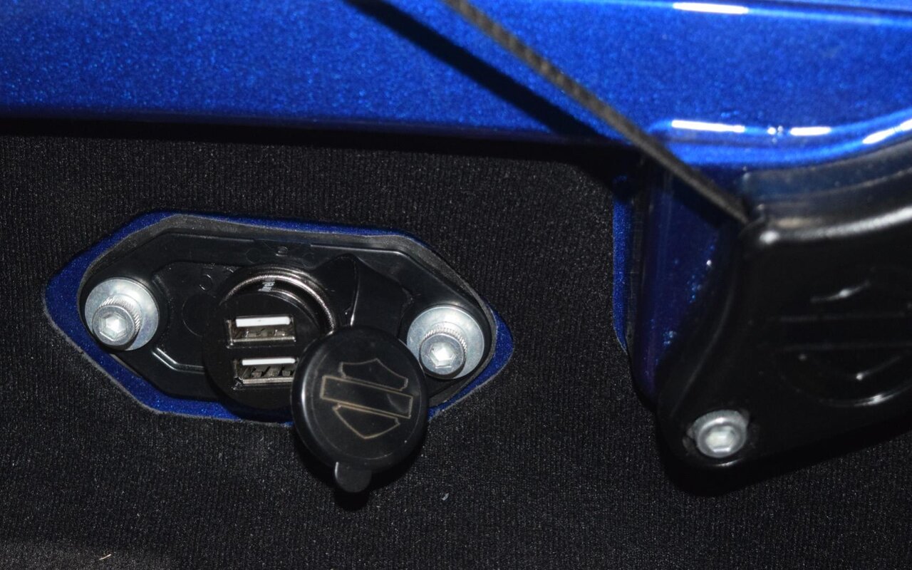

Provided 12V, or plug in usb converter to charge 5V devices
Start to finish about 10 minutes
One of multiple ways to get more power

Steve, started to install like yours with just wiring coming to components velcro to wall, but found cable to just have a flush plug, too many times on trips (like recent Hollister run) have too much in the trunk and with taking it in/out each night, afraid of messing it up. Now I can have it both ways.
