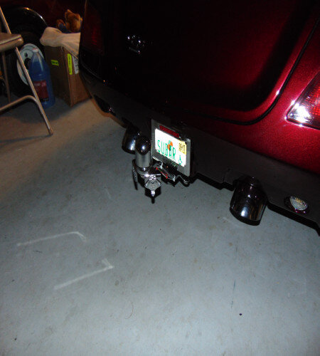

We have a 2008 1800 and we just had a CSC Viper kit installed this month. We also put the trailer hitch on and are enjoying the shin buster. We will get accustomed it being there. We did install a Kuryakyn plug connector under the ball part number KU9183. It sure makes it easier on connecting the wiring plug and connecting the chains. Hope this helps.

Did your Viper kit come with the round connector or did you have to rewire it. Reason I ask, mine is rectangle.
Our kit came pre-wired with the rectangular plug. After talking with the factory customer service I found out that, that specific plug is used for the CSC's Escalade trailer. After asking the dealer, prior to talking with CSC, he gave me the trailer end of the plug. I used their rectangular plug and made a jumper cable to go from the kit to my round electrical plug. Myself I installed the Kuryakyn hitch adapter (KU9183) and wired my trailer to that plug. Zip tied the wire under the hitch arm and called it done! If you need more help let me know. I did have other problems with mounting bolts. PM me and I will fully explain.

subar...question
subar...question
Mine was the rectangle one, I had to go back to dealer to get the other side of the plug (that was intended to connect to the trailer). After that I hard wired that plug to the trike and ran wires to the hitch ball and installed a Kuryakn trailer plug connector. I am having problems uploading pictures of my setup if you will give me an email I will send you picture of the hitch.DSC00022 Test #1.jpg

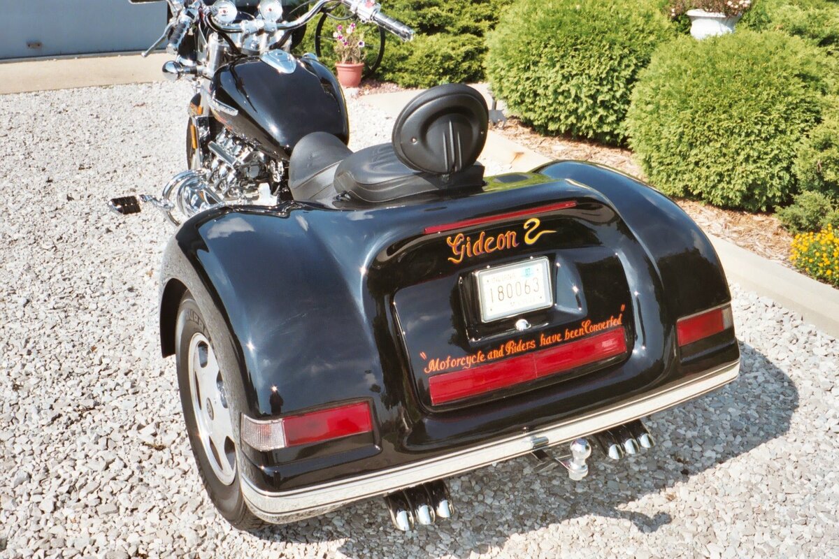

Appreciate the info and the pics. Been thinking of doing the same thing.
...ron
I was told that the plug that came with the trike kit was designed for the CSC trailers, so you will have to have both sides of the connector to make things easy, The connector I used under the ball is Kuryakyn KU0183. It comes with all you will need except the wires and electrical tape. Good Luck with it.
