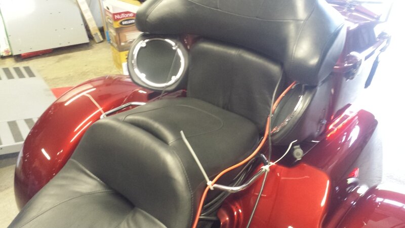

I'd just temporary wire it in and remove it once your done tuning, that is what I do when I tune with a TTS.
WIres run, USB cable, power to computer and wire to TTS dongle.

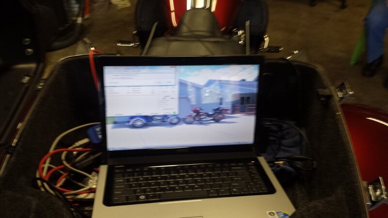

Laptop in the tour-pak.

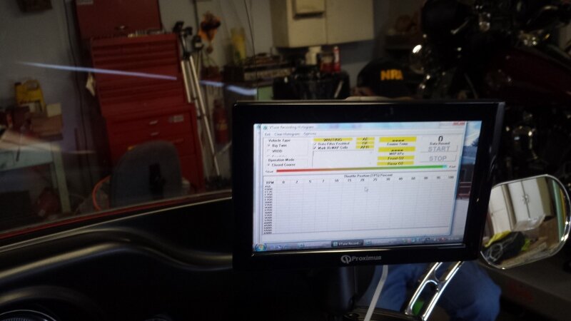

Remote monitor so I can start V-tune session and see what cells I'm hitting.
