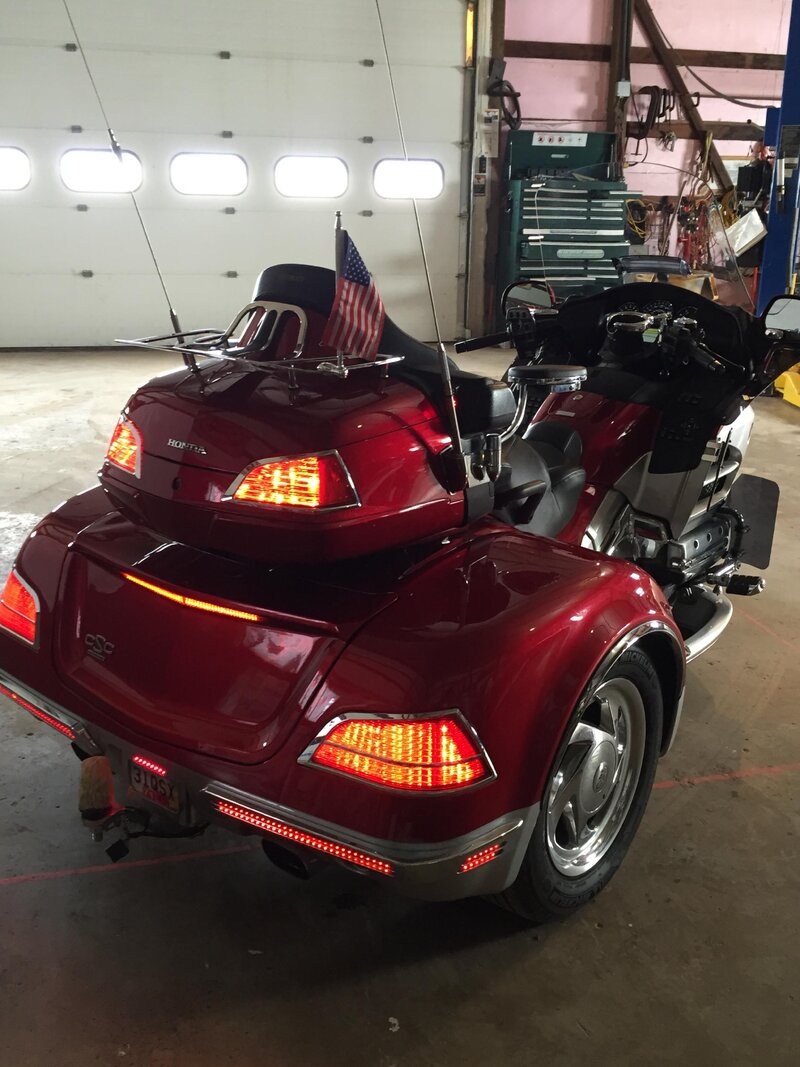

Cavie, it can be done. Not the 8 to 12 inches you mentioned but you can get 5 inches. That puts the top tour pak in line with the top of the lower trunk lid on a CSC Viper kit. The Boss was all smiles when she got on and could sit without her knees being cramped.

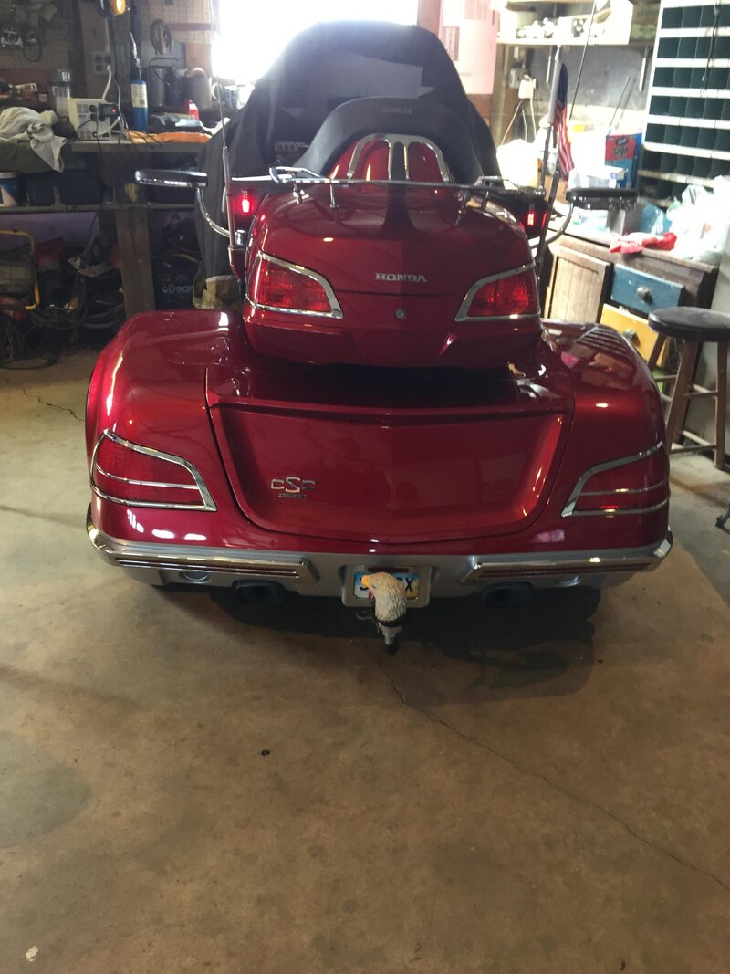

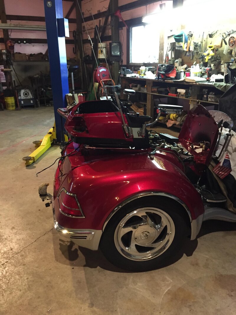

Removed the top box, added a piece of 1/4 annealed aluminum, re-drilled the holes for the top box mount in the new plate and the fun began. I cut the bottom shelf off of the top box, where the radios were installed. This allowed the top box to set flush on the plate. The cavity in the trike body that the bottom shelf of the top box was occupying, is where I mounted a weather tight aluminum box to put the radios back in there original location. No radio wires to splice this way.
The wire loom for the Navi is long enough to allow the unit to be kept in the original location without splicing any wires. The wire loom for the back seat speakers can be relocated, no splices needed again. I did splice the wires for all of the lighting and electric trunk lock with heat shrink crimp connectors. I had to make a new bottom trunk release cable.
This CSC Viper kit did not have an emergency bottom trunk release cable, as a lot of other kits do. I added this to the cable just in case my bottom trunk release fails.
Took the seat to a local shop where they removed the cover, trimmed the foam to remove the raised portion on the copilot part of the seat. He then made a new 5" wide cushion to fill the void created by moving the top box.
