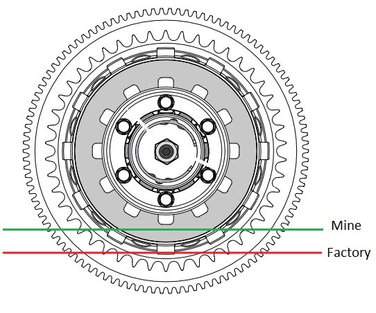

2014 - With lift kit - I use 40 ounces of H-D Formula+ primary fluid. You gotta keep that compensator up front lubed well. I've never had any slippage issues in 32k miles. I change it every time I do the motor oil change. (Tranny every other time).
Hey Mr. Fixit,
Papa Zook gave great advise I think by stating to go with the manual recommendation that came with the trike...........However, I misinformed ya'll by stating the book calls for 38 oz for wet refill and 34 oz for same refill in another book place...........I went back to my 2016 book that came with trike and it says wet refill is 34 oz in 2 different book places... (38 oz. for Dry refill only) ...trike book also states "Do not overfill" as it may cause difficulty with locating Neutral and clutch slippage. ect.
...anyway, 34 oz. takes my refill level to appx 1/2 the distance between your green factory line and your personal red line level on your diagram. (34 0z. level stops just at the clutch plate)
.......so, I guess it doesn't matter if the clutch pads are partially covered with the refill?
....and exactly what is the compensator you refer to and where is it located? (Yes, I know its a dumb question but I'm new to motorcycles....still learning):xzqxz:

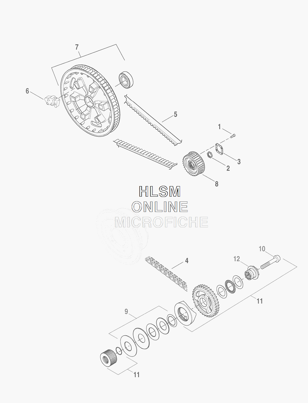

#11 is the front compensator sprocket it gets lubed from the primary oil
Ok, I studied compensator diagram and went to youtube so I now understand about the compensator......Looks to me like in order to get primary fluid lever close enough to level of compensator location=It will require appx. 38oz (wet refill) of primary fluid ...I see why Mr. Fixit uses 40 oz. with lift kit. (according to his diagram)
.....This 38 oz. (or 40 oz.) refill definately takes the primary fluid level above the clutch pads bottom level and submerses pads somewhat in primary fluid it appears.
....so, evidently this does not cause any issues with most of ya'll ? .....the 38-40 oz level most surely helps the compensator lubrication issue.

No the compensator does not however the spokes pick up the oil and lubes the sprocket and chain The inner parts of the sprocket are supposed to get lubed this way
HD has had trouble in the past with fretting of the sprocket, the newer version have addressed this issue

This is a compensator .... and lack of lubrication leads to problems.

Note how the compensator works to reduce drivetrain shocks caused by the jerk on the seat. The spokes try to climb the cam (against the spring) when the wheels slip then grab or when the jerk jerks the throttle on/off. Only a slight film of oil is needed and then not in normal driving and the chain carries up more than enough. I never paid any attention to the quantity specified in the manual but rather filled the case until the chain was just submerged where it passes under the clutch. The first time I ever heard of a compensator wearing was right here. Naturally YMMV. :qpnmt:
The older (preTwin Cam) comp sprockets were stout design with a heavy spring and deep cut lead in ramps
These worked good for many years, and never failed
I guess the MOCO decided to out smart it self and have 100s if not 10000s of failures with the early 2 comp sprockets designs
Good thing for all on ALL the new bikes they have the current and best comp sprocket with a retro kit including a bigger alternator kit for older twin cams

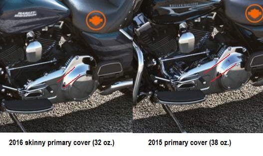

FWIW ... Skinny Primary explanation > and the wet fill oil quantity I am pretty sure is right for those years listed.
