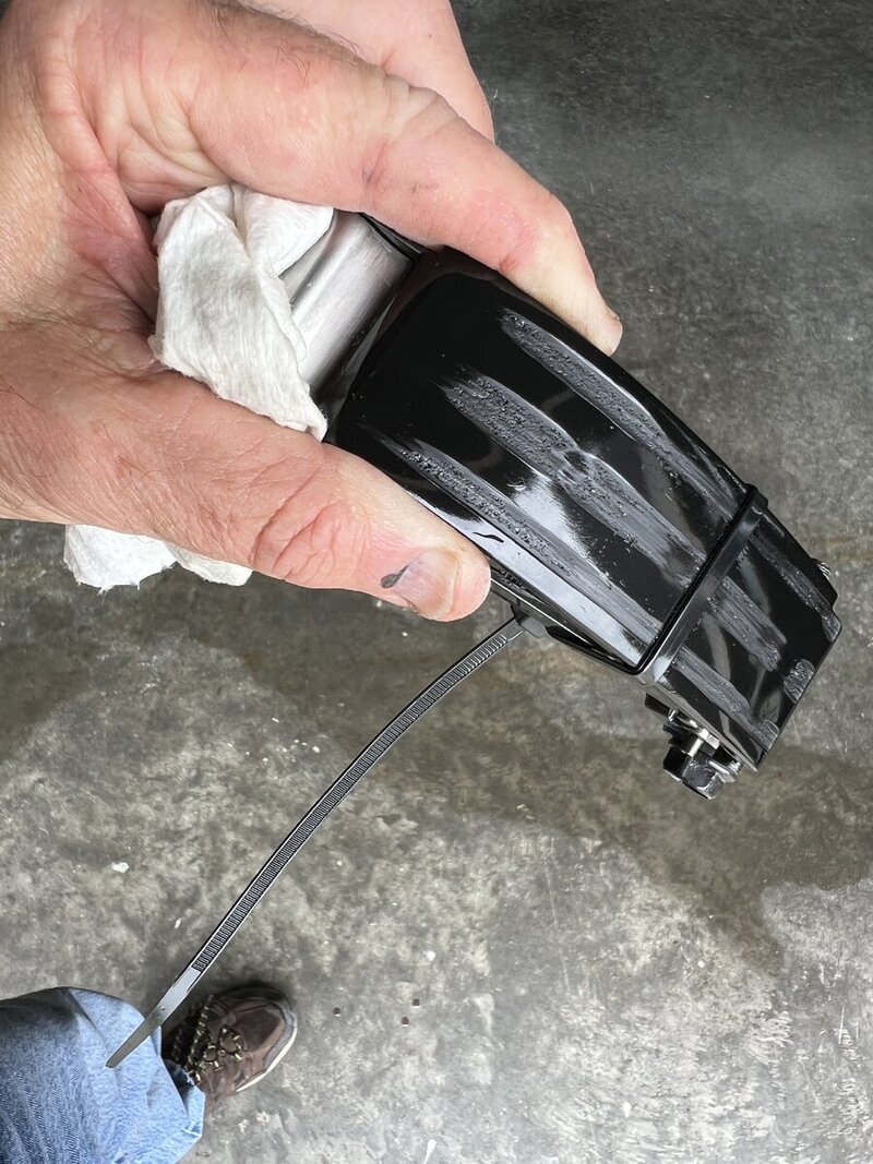

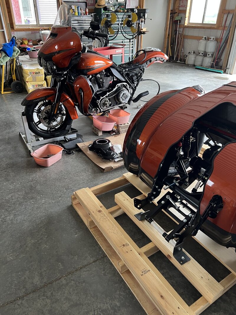

So I started the install this afternoon of my Roadsmith conversion kit on a 2020 Ultra Limited with 20,000 miles on it.
Got the bike stripped down and started to take the Primary apart to change the belt. Took the primary chain adjuster out and looked it over and discovered some wear that looked unusual to me. Sent a picture to the dealer and they thought it was ok. I don’t think so and they said it would be 4-6 weeks to get the part. Don’t want to replace it if not needed, but not too crazy about putting it back in. What say you?
I would like to upgrade but I’m finding several bad reviews on the Baker and other aftermarket manual adjusters. I would put the Screaming Eagle one in, but it says on the Harley website it doesn’t fit my 2020 bike with the M8 in it.
I would just put the regular one in there. I have run a Hayden tensioner in my other bikes with zero issues. I do see the bad reviews as well but there are tons of them out there in many bikes with tons of miles. The idea of having a floating tensioner appeals to me.
Only thing I don’t like about the attitude adjuster is you have to remove the whole outer primary to adjust. But, I guess if it’s adjusted correctly you wouldn’t have to re adjust it. I’m a bit torn with that, I know how to do it. I just am not sure which way I will go when the time comes. Only 5000 on my trike.
I just put one in a 2018 Road Glide book said it would not fit & it did not, on the outer primary cover we had to grind off about a 1/4" of the casting vein or whatever you want to call it. I had used a lot of Hayden's, the shoe came off of mine got caught between the primary chain & the clutch hub, bent the crankshaft & cracked the left side engine case, no warranty Hayden did nothing, I had no luck with Baker. I watch a lot of Moonshine Harley you tube videos they make some BIG HORSEPOWER MOTORS they only use the Screamin Eagle adjuster.
