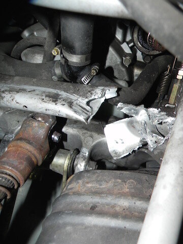

Here is a shaft that was not inspected per the manufactures recommendation. According to the customer, it was 700 miles over due. Keep in mind that u-joints don't instantly wear out. They fail over a long period of time. When this u-joint broke apart, it destroyed part of the right frame rail, broke or destroyed 2 of the 4 cross bars between the frame rails, and bent the output shaft coming out the back of the engine.
Fortunately no one was hurt. This all happened as he left a stop sign at maybe 3 mph.
Below is a destroyed cross bar.

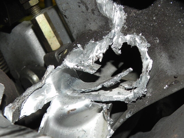

Here is a badly damage frame rail.

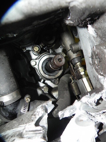

Below is a bent output shaft at the back of the motor.
