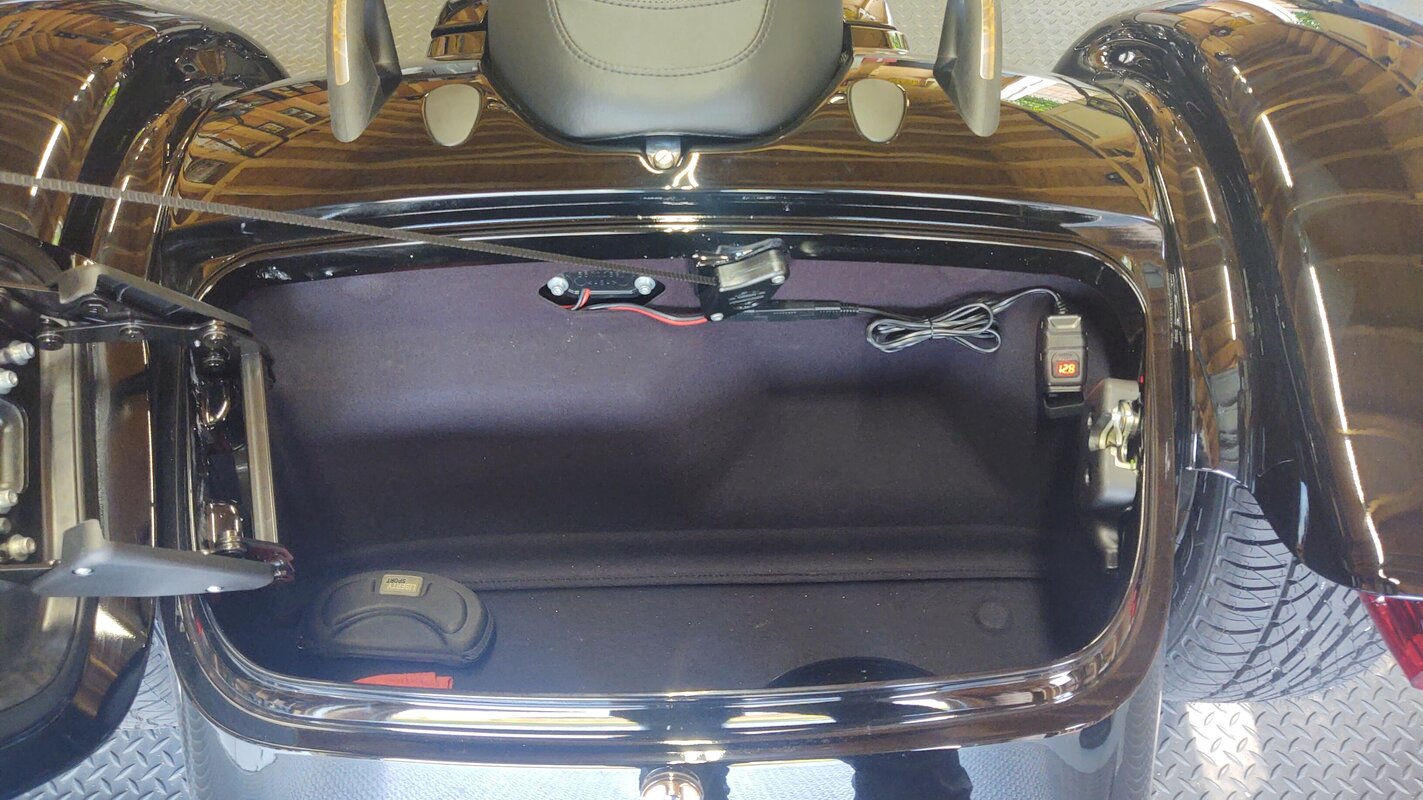

Easy. Choose a fused 12V automotive power outlet with USB port if desired, and crimp ring terminals to the leads and attach directly to the battery. Theres a diamond shaped plastic boss at upper back of trunk you can drill and run the cable through. You can use velcro to attach to the trunk liner. It will always be hot so she can charge with bike off.

I bought this guy for $16 and put a "Y" splitter on my accessory cable that's tucked under the left side panel. Took off the access plate in the trunk and notched out a hole big enough for the wire to pass through and velcro'ed the unit to the carpet out of the way. It's been there for a year and works great. Lots of choices for not much money out there.

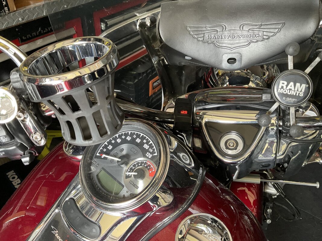

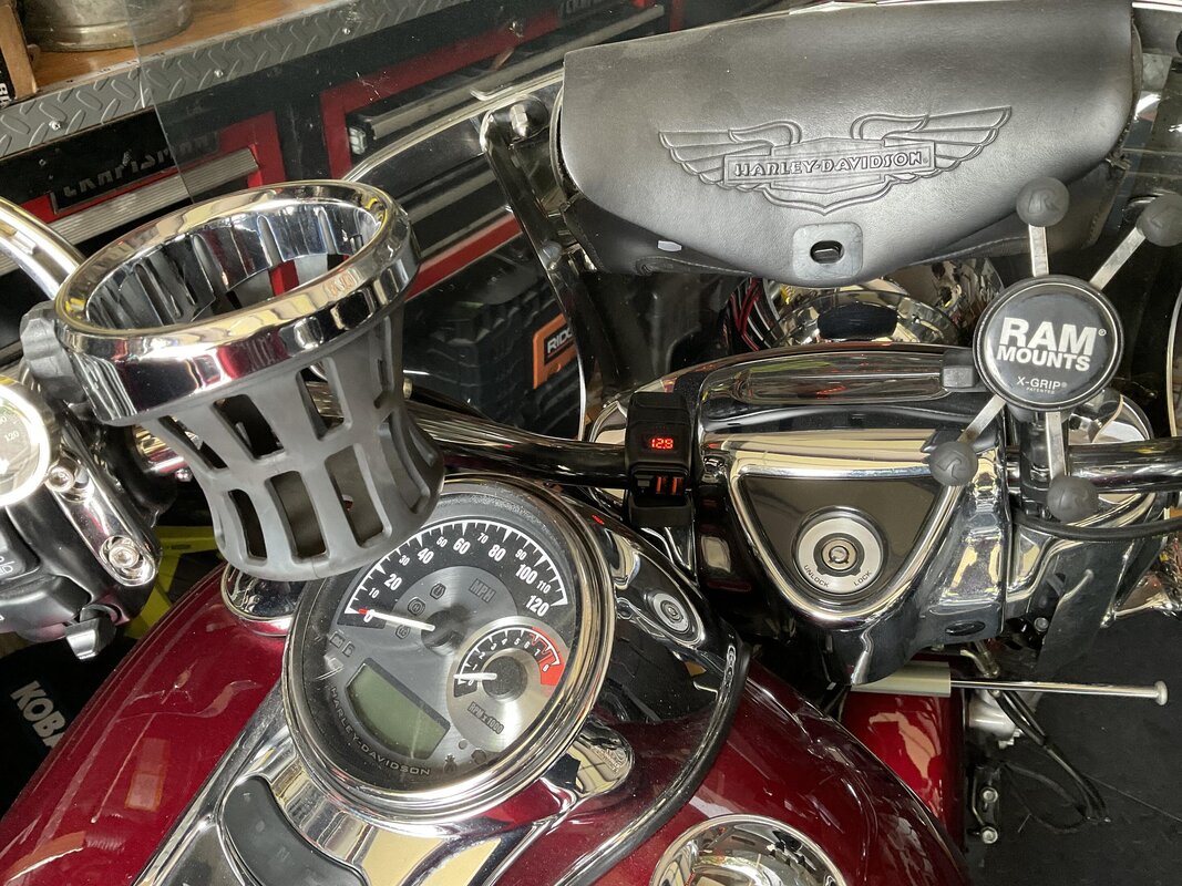

I might suggest something like this. I use this to charge my Cardo Pack Talk in case I neglect to charge overnight in the hotel. Youcan find this on Amazon for less than $15. Plugs right into your tender connection.
[h=1]YONHAN Motorcycle USB Phone Charger 4.8A, SAE to USB Adapter with Voltmeter & ON/Off Switch, Dual Port Fast Charging 3 Install Options Waterproof Quick Disconnect Plug for Smart Phone Tablet GPS[/h]
