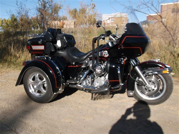

No, No, I'm not about to let go of my old tour glide:

Did what your talking about..93 FLHS got 15k in it all rebuilt runs strong. Got the 80" in it with a Crane Fireball 300-2B for low end torq. 5 speed with mechanical reverse. Now for speed ya I am not going 90 or a 100 out there but it will cruise 75 all day long with burst's to 85. Keeps up with the twin cams in our group and runs a lot cooler. Any way if someone is thinking of taking an older Evo and making a trike do it. Makes a nice trike easy to work on and a hoot to ride most new people have no idea what it is new old what? :Drsz_img_0599.jpg
