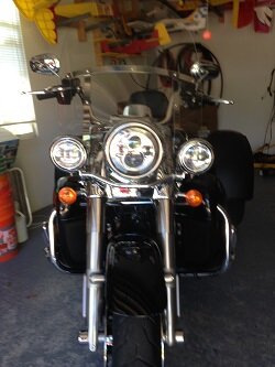

I used a RK light bar and aftermarket passing lamps with LED's.Turn signals stayed in original position.
Would you happen to have the part numbers for that Road King light bar assembly?
Did you have to modify the headlight nacelle ?
Sorry to bother you but that looks really nice!

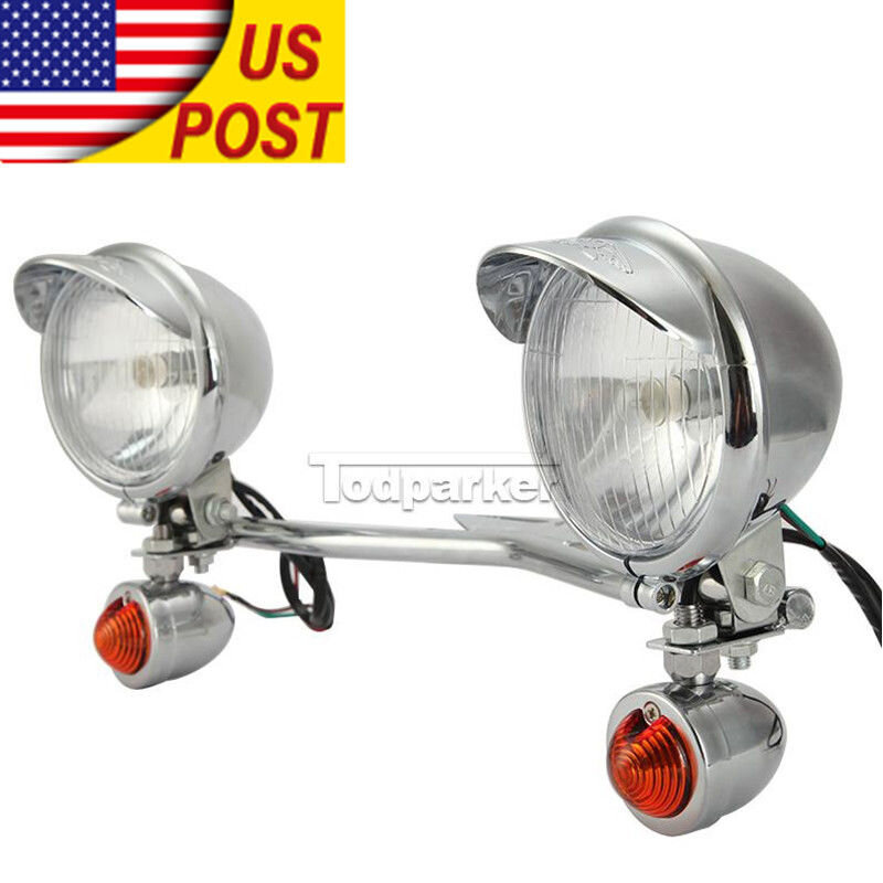

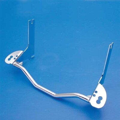

Found 2 styles of light bars with different mounting points/ Which one did you use?ThanksLight Bar 1.jpg

DUH, I think I finally understand. The light bar attaches to the same points as the windshield, right? Top light bar pic ?
Now you got it. It fits to the outside of w/shield bracket.If you do not use a w/shield,it still mounts to outside of grommets.Easier to install the light bar with the w/shield off the bike.
